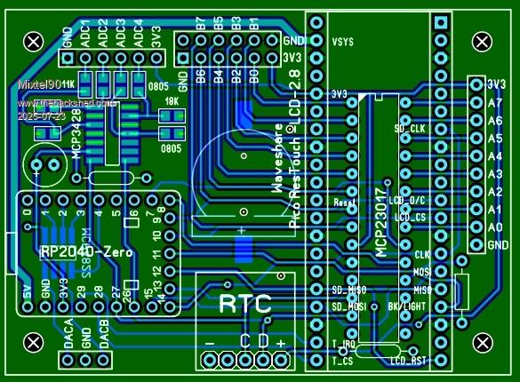

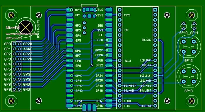

I designed a couple of little backpacks for it a while ago, so it is possible to do things with them. I never actually made either of these. :)

Nice job Mixtel!  I really like the second one with extra I/O, RTC and data converters.  Nice work.  An amazing group here.
