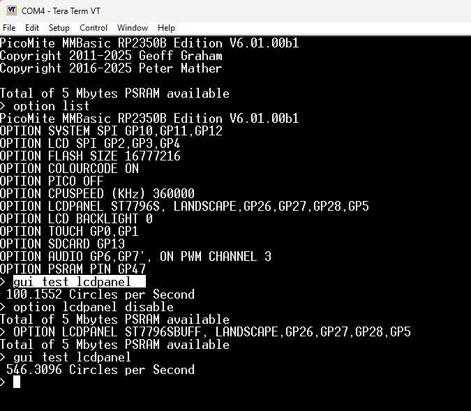

High speed buffered display drivers
The new release supports the following new display drivers
ILI9341BUFF: 320 x 240
ST7796SPBUFF: 320 x 320
ST7796SBUFF: 480 x 320
ILI9488PBUFF: 320 x 320
ILI9488BUFF: 480 x 320
ILI9488WBUFF: 480 x 320 'Waveshare Pico-Restouch-lcd-3.5
ST7789_320BUFF: 320 x 240 'Waveshare Pico-Restouch-lcd-2.8
In all cases enabling one of these drivers steals a RGB332 framebuffer from the heap so in the worst case of a ILI9488BUFF heap is reduced by 150K bytes (from 300K)
To use one of these drivers you first need to allocate the SPI pins to be used
OPTION LCD PINS clkpin, mosipin, misopin
These pins are dedicated to the display and must be separate from any pins used for the SYSTEM SPI which may still be required for touch and the sdcard (NB: in the case of the Waveshare boards using this driver will conflict with also using touch and the sdcard as they share the SPI channel)
The reason for the dedicated pins is that the screen updates will all take place on the second processor and for maximum performance this cannot share the SPI channel.
How much faster are these drivers? I've included in GUI TEST LCDPANEL an output when you exit the test that reports the number of circles drawn per second.
MUCH FASTER!!!
AFAIK all normal graphics work using the new drivers and they are tested with Petscii and work properly. Using these drivers, the use of the ILI9488 and particularly the ST7796S displays work very well as console devices. For maximum performance with the ST7796S display a CPU speed of 360MHz is recommended. This allows the SPI channel to the display to run at 90MHz giving a full screen refresh time of about 14mSec with no load on the main processor.
Of course the downside is that the screen is only using 256 colours instead of the full 65536. A later beta will include a MAP capability so that you can select the 256 colours to be used out of the full RGB888 palette.

Posts: 12059
Posted: 12:21pm 23 Jul 2025
Don't understand the question about images. It has always been possible to load a 480x320 image from the sdcard to the display or a framebuffer.
The B option works exactly the same. Because the 2nd processor fifo is queued the background copy or merge just takes its place in the queue. The only difference being that the activity takes place between the framebuffer and the LCD RGB332 buffer. The actual physical update then takes place the next time the background copy to the display happens. All graphics commands set variables low_x, high_x, low_y, high_y which indicate the area of the screen that needs updating. The background update then just updates the area needed.
This gives a huge gain for things like circles because a single update does the whole thing rather than each pixel in the perimeter being updated separately

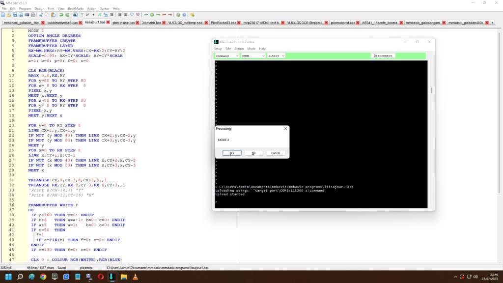

Posts: 2807
Posted: 08:07pm 23 Jul 2025
loads but doesn't erase an auto run existing prog or settings for previous and took a while before usb kb seen or terminal kb working
PicoMiteHDMI MMBasic USB RP2350A Edition V6.01.00b1
OPTION SERIAL CONSOLE COM2,GP20,GP21
OPTION AUTORUN  ON
OPTION FLASH SIZE 4194304
OPTION COLOURCODE ON
OPTION KEYBOARD UK, 0, 0, 600, 150
OPTION RESOLUTION 1024x768 @ 375000KHz
OPTION DISPLAY 32, 64
OPTION SDCARD GP2, GP6, GP7, GP4
OPTION DEFAULT FONT 3, 1
?cpuspeed 0
Edited 2025-07-24 07:04 by stanleyella
Posts: 3416
Posted: 09:37pm 23 Jul 2025
  manual said  MM.INFO$(CPUSPEED)  Returns the CPU speed as a string.
Posts: 2807
Posted: 09:52pm 23 Jul 2025
what's this new box and how to bypass it when flashing prog? please
Posts: 6626
Posted: 10:09pm 23 Jul 2025
Stan,
Your problem is nothing to do with the new MMBasic betas.
You have selected "command" as the device instead of picomite
