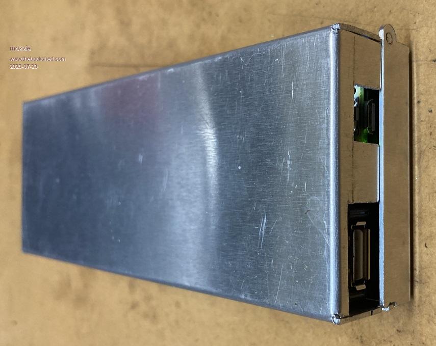

G'day All,

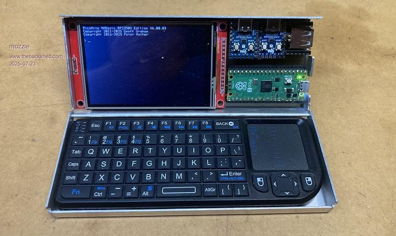

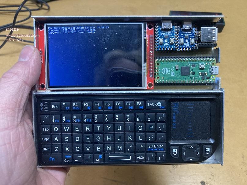

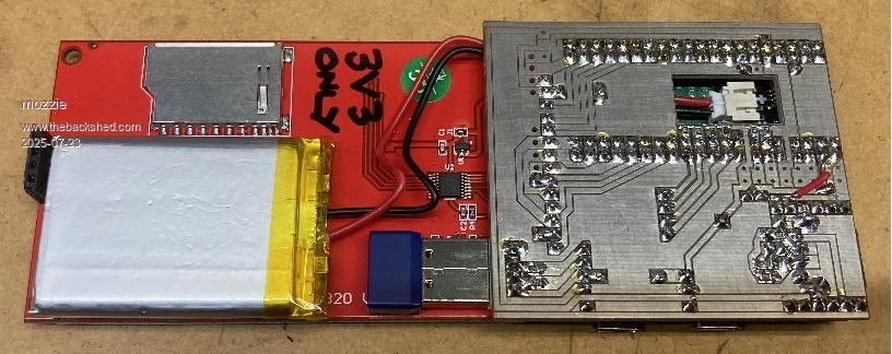

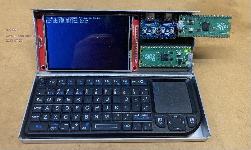

This as an idea has been floating around the grey matter for a while, and has finally become a prototype.
I work away a lot, and having this to test ideas without firing up a laptop has been a great learning tool.
Having the "HELP" system inbuilt is also great when the brain has a moment of fade
The final design is intended to allow you to play around with MMBasic programs on the inbuilt Pico2 using the
wireless keyboard / mouse and inbuilt ILI9488 screen (about to be upgraded to ST7796), the keyboard can also be
removed and used separately.

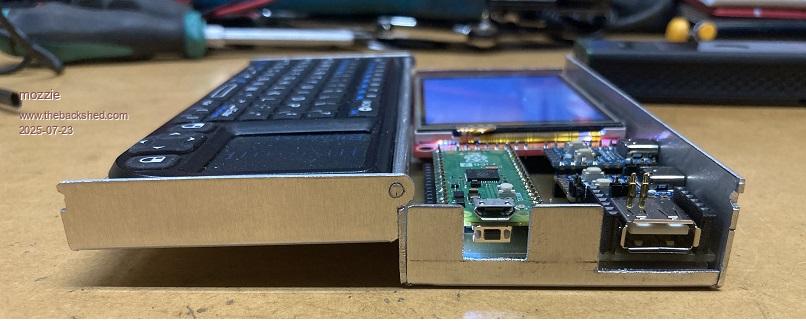

By connecting a USB lead to an external Pico and using an inbuilt terminal program, be able to edit programs
on the connected Pico.
By fitting a Pico to the internal headers / POGO pins, same as above.
The PicoZero on the left does the Keyboard and Mouse USB to PS2 interface, the keyboard will work with the USB version
of the Picomite firmware but the mouse uses an odd reporting method, hence the external processor.
The PicoZero on the right is the CDC interface to the external PicoMite / MicroMite.
These both use modified versions of the Terminal software from a Silicon Chip Magazine article.
The MMBasic terminal program is still a work in progress, mostly works but very crude in places, its looking like 6.01.00
is going to be a big step in the right direction, although a new PCB is already required.
I have got to the point of wanting to get the mouse working in my Terminal program, and am asking for some help.
According to the manual, using PRINT@(X,Y,M), the (M)ode should, in Mode 5, invert the current pixels, however
after much mucking around with ILI9488,ILI9341 and ST7796 LCD's (with MISO connected) I cannot really get a sense
of how this works. Also tried this on framebuffers with no success.
Ideally this would function like the cursor in the inbuilt editor, inverting the pixels at the cursor location,
but I may have simply got the wrong end of the stick, not an uncommon situation...
Has anyone had experience with this or can shed any light?
The current program uses an array of strings as the framebuffer but is not ideal.

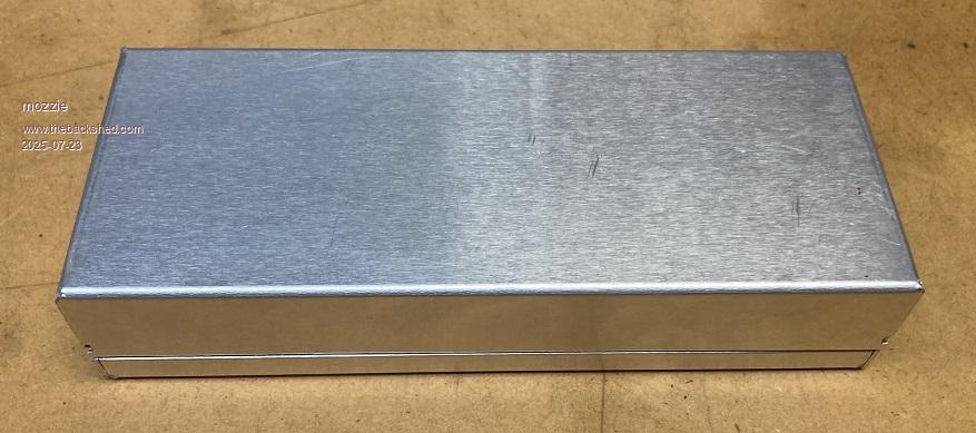

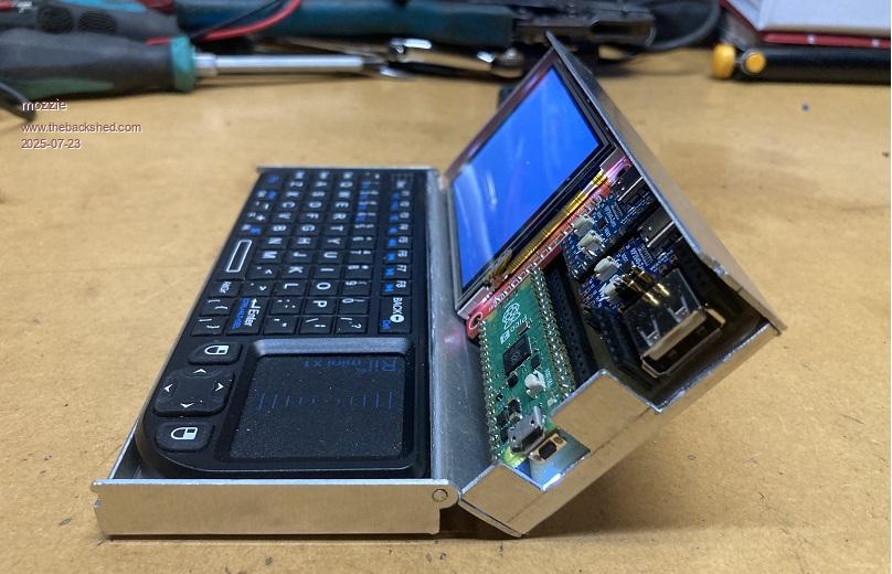

The next version will have plastic printed ends on the aluminium channel housing, this unit was folded out of a piece of
1.2mm Aluminium sheet.
There is also a much larger version planned using a 7"/8" HDMI LCD and keyboard, but that is a future project.
My thanks go out again to Geoff, Peter and everyone else on the backshed who have made MMBasic and the
MaxiMite / MicroMite / PicoMite as awesome as it is.
Lyle.

Thanks for all the positive comments, we did metalwork at high school (37 yrs ago) and it has always been a source of pleasure when an idea turns a flat sheet of steel / alloy into something 3 dimensional.
Sadly this appears to be another skill that is no longer being taught
The next version will use a simple folded U-channel with 3d printed ends, makes a very simple and solid enclosure for very little outlay.
Also having a small guilotine and pan brake makes a world of difference.

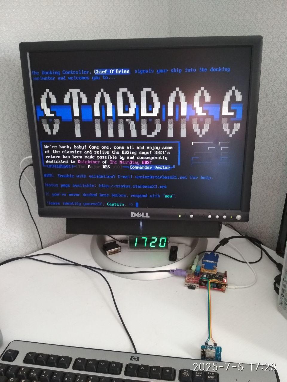

Probably a good time to ask before re-inventing the wheel, has anyone written a ANSI / VT100 terminal in MMBasic?
Lyle.
PhenixRising
Joined: 07/11/2023
Posts: 2100
Posted: 03:24pm 23 Jul 2025
  Quote  has anyone written a ANSI / VT100 terminal in MMBasic?
Gemini just had a go although it has some weirdness.

  mozzie said  Probably a good time to ask before re-inventing the wheel, has anyone written a ANSI / VT100 terminal in MMBasic?
G'day,
I am also very interested in this question!?

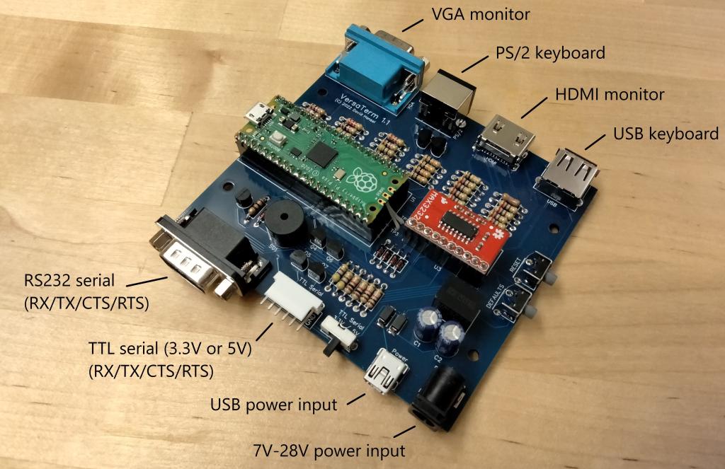

I use the VT-100 VersaTerm firmware for Pico to access the Internet via a retro Wi-Fi modem on the ESP8266 module..
javavi.

VersaTerm - A versatile DIY serial terminal on Pico (RP2040).
https://github.com/dhansel/VersaTerm
I think that PicoMite will also be able to emulate the BT-100 terminal on MMBASIC, but for this you need to write such a program. I thought that a solution already exists!
