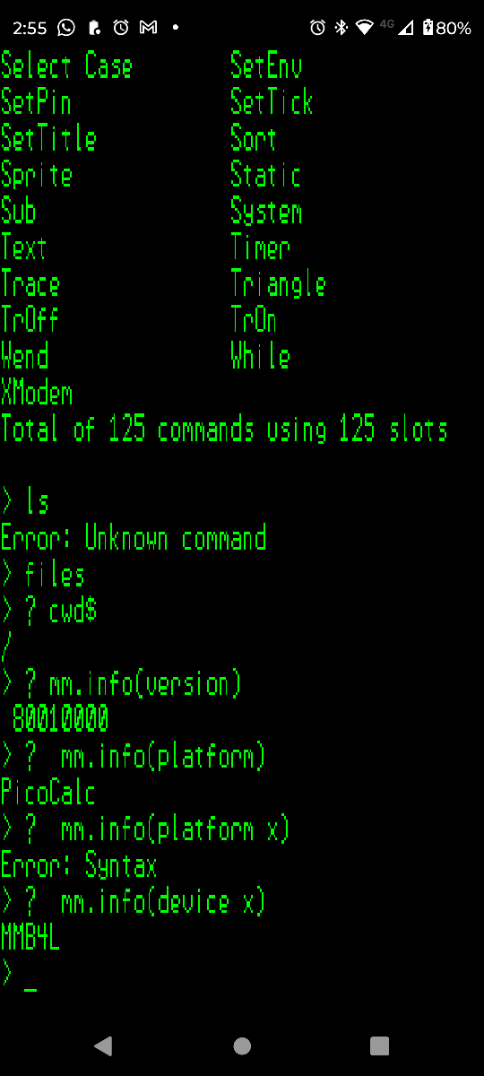

Hi folks,
MMBasic running natively on an Android phone:
I've proved to myself (~90%) that it is do-able - though with a Bluetooth keyboard for input at the moment.
Nobody hold their breath for a download though, there is a very long way to go before I'm going to consider that.

Sometimes the "simplest" things are the hardest.
I've got soft-keyboard integration, execution of immediate mode BASIC statements, sound and graphics but no useful file-system; modern Android does it's damnedest to sandbox apps and keep them away from the "Documents" folder ... I'm figuring it out but .
EDIT: it doesn't help that it can't all be done in C/C++ you have to call to and from Java (or Kotlin), what a ball-ache.

The initial target device is my personal phone (a Moto g32 running Android 13).
MMB4A v1.0 will be targeting two use-cases:
- Programmable calculator
- Game*Mite substitute
This means no Wireless, Bluetooth or kitchen sinks initially - sorry folks.
If I get that far then we will see what the future holds.
Edited 2025-08-08 02:25 by thwill

Hi folks,
It's a bit flakey but I have a file-system and can RUN a program:
   https://www.youtube.com/shorts/mSnW4Dxcmdc
Note that the "programmer's" soft-keyboard is a 3rd party app (https://github.com/Julow/Unexpected-Keyboard).
Next up, the EDITor.
Edited 2025-09-04 18:19 by thwill
