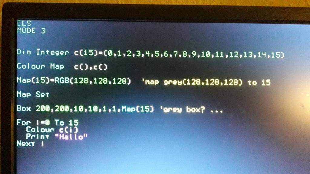

Hello,
obviously I am to stupid to understand colour mapping.
I am using picoMite HDMI, latest version on Resolution 848 in Mode 3.
I tried everything to pick a colour from the RGB palette but can't get ANY change in colour not grey not blue nothing. It doesn't react at all.
Testprogram:
This should print the last (15) colour in grey, instead of white.. But it doesn't. It prints white. But no matter what colour I pick as an RGB value, there is no change at all.
Then I tried out of couriousity:
MAP GREYSCALE
Doesn't work either: Syntax Error...
Also, I think in the manual is an error (typo?)
Page: 177
MAP(8),RGB(100,100,100)
MAP SET
Pixel x,y,map(8)
Shouldn't it be: MAP(8)=RGB(100,100,100)  ??
But even this example doesn't work.
I have no clue what to do. Could anybode please give me a working example of your choice?
Greetings
Daniel

  Amnesie said  Hello,
You're mapping gray to color 15. After MAP SET when you specify color 15, you'll get gray. Instead of Map(15) at the end of the box statement, try just the number 15.
Box 200,200,10,10,1,1,15 'grey box
At least that's what I think the manual is saying.
