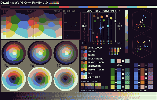

I have only one small suggestion:
I use a colour palette in which black isn't complete black, but RGB(20, 12, 28)
like in this demosntration of the colour palette I am using (this is not mine, nor made by me!):
original source
But I think there is indeed a justification for also make "black" adjustable. This is my favourite 16 colour palette, even for games it offers many many options.
In your version it seems I can't change black. Same for white!
But as said: this is a great piece of software you made! Wow! I LOVE those sliders!

The program is written for 640x480 HDMI (Mode 3), I forgot to mention this.
But should work on VGA 640x480
Choosing the right color can sometimes be crucial in how you experience a program or application. I was a little interested in using "DrawBars" to set the RGB values, thinking that this should be easy and cool. You get a different feeling of what happens to the color when changing the value with "DrawBars". But you can also type the values directly.
I had to lock White and Black, otherwise it would not be possible to read the program text on the screen.
/Peter63
Yes, absolutely!
Ah ok, I didn't thought about that. Ok, it isn't hard to add those two values later by hand.
I played a bit with the program and can't find any problems so far! Great experience!
