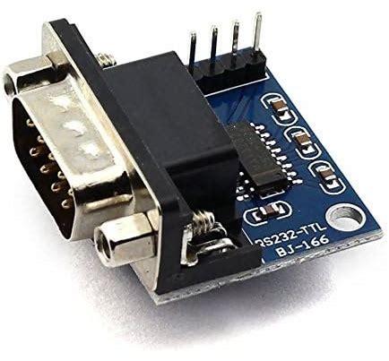

I use that printer with a Pico 2W and it works fine. I use a TTL to RS-232 converter such as this one:
Once that MAX3232 adapter is connected to the Pico, what is the cable layout to the printer? Do you need to take into account the CTS pin and the voltage of the printer connector?
toml_12953
Joined: 13/02/2015
Posts: 736
Posted: 01:14pm 03 Aug 2025
  grroel.tech said
I use a straight-through connector. I have a 9-pin to 25-pin adapter on the back of the printer and a gender changer since the adapter has a female 9-pin side and the cable I use to connect to the MAX3232 needs a male. You connect the Vcc and Gnd connectors on the MAX3232 to the PicoCalc. Connect the RXD and TXD lines to the corresponding GPs. If you get no response, switch RXD and TXD. It's that simple.

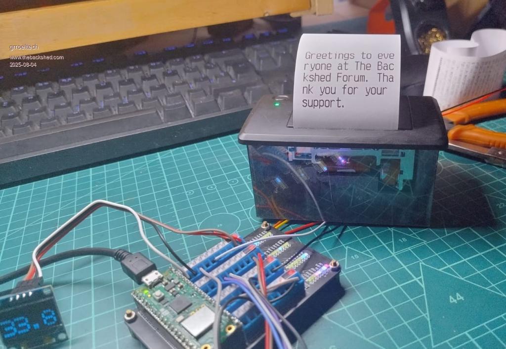

grroel.tech
Joined: 09/12/2021
Location: Spain
Posts: 28
Posted: 06:30pm 03 Aug 2025
The simplest solution is the best.
The printer's RX and TX lines are reversed, as they said on AliExpress.
I connected only the TX line, pin GP4, and ground from the Pico. At 9600 baud via COM2, printing was successful.
Thanks for the replies.
Best regards.

As shown in the PicoMite manual:
DEVICE SERIALTX GP4, 9600, ‘Hello, World’
does not work. With SETPIN, OPEN as # and PRINT# it works.
Any clues?
Posts: 6197
Posted: 06:07pm 05 Aug 2025
Hi Grroei.tech,
Yes, I have a clue....
First of all, I just double checked, and using a UART, or using SERIALTX does not make any difference. The signals on the CPx pin are the same. Tested on PicoMite RP2040 VGA.
About the clue:
You are sending a single string via a GPIO pin. Before you can send the data, you have to make sure the port (or pin) is set up correct. Using UART this is performed by the OPEN command.
With SERIALTX, at the moment you give the command, the pin is typically in INput mode.  Which is 0V. However, the 'idle" level of the serial port (TTL serial levels) is +3.3V.
There are 2 options:
1/ hardware: connect a pullup (i.e. 10k) resistor from the GP pin used for TX to +3.3V. After this SERIALTX will work correctly. This will cause the signal to be "idle" for serial before the first SERIALTX.
2/ software: At the start of your program, set the pin used for TX to DOUT and HIGH. Then wait minimal 1 UART character time.
SETPIN GPx,DOUT : PIN(GPx)=1 : PAUSE 10
Good luck with the thermal printer...

Posts: 12059
Posted: 07:08am 06 Aug 2025
There is a bug in DEVICE SERIALTX in 6.00.03. It may work on GP0 but no other pins. Will be fixed in 6.01.00
