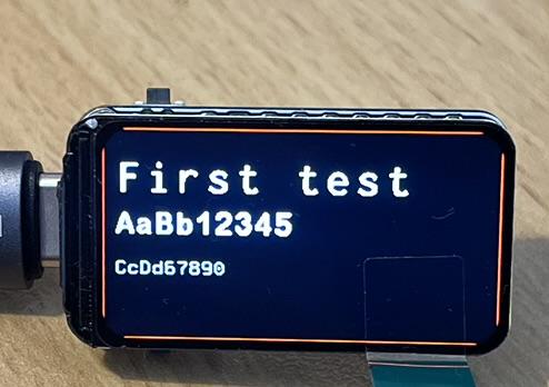

The display with the RP2350 intrigued me, so I bought one without pins. A computer-savvy colleague suggested it, and I recommended it in MMBasic. It worked for him. Now I've started testing it myself, and this is my first result.
Because the display has rounded corners, you can't draw right up to the edge. The image is perfectly sharp. Unfortunately, I can't capture it any better in a photo. Loading files also worked for my colleague, and he was able to display .jpg files.
According to the description, the RP also has a built-in temperature sensor and a clock. I still need to test those features and image loading. But I'm very happy with my initial results.
'PicoMite MMBasic RP2350A V6.02.00
'OPTION SYSTEM SPI GP18,GP19,GP20
'OPTION FLASH SIZE 16777216
'OPTION COLOURCODE ON
'OPTION CPUSPEED (KHz) 200000
'OPTION LCDPANEL ST7789_320, LANDSCAPE,GP16,GP6,GP17,GP21
'OPTION SDCARD GP15, GP10, GP11, GP12
x0=0
y0=34
x1=320
y1=205
cls
line x0,y0,x0,y1,1,rgb(red)
line x0,y1,x1,y1,1,rgb(red)
line x1,y1,x1,y0,1,rgb(red)
line x1,y0,x0,y0,1,rgb(red)
text 10,60,"First test",,5
text 10,100,"AaBb12345",,3
text 10,140,"CcDd67890",,4
Edited 2026-01-28 20:47 by v.lenzer

Wiwaldi
Joined: 25/11/2023
Posts: 1
Posted: 12:46pm 28 Jan 2026
A lovely toy
Attaching the module is a bit tricky, but a 3D printer will certainly help.

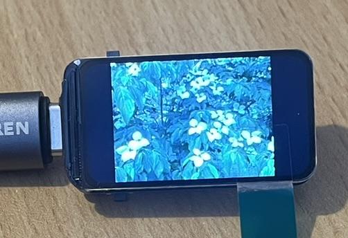

Images are very easy to import. The quality is very good. I didn't expect that. The image format must be N x 172, where N cannot be larger than 320. Using `<load jpg "name.jpg", X, 34>`, you can get the image to fill the screen completely, both top and bottom. X is 40 for my image format, so it's nicely centered on the display.
The GPIO for the RGB LED is 22. Since the LCD frame is transparent, the light is diffused all around. It looks good. However, the colors are reversed. I haven't figured out why yet.
I couldn't find any I2C pinout in the schematic. Presumably, you can't read a clock or a temperature sensor. I have no idea what the manufacturer was thinking with that description. I also can't find a GPIO for a one-wire connection.
The photos don't do the image quality justice. Please keep that in mind.

Posts: 12058
Posted: 06:12pm 29 Jan 2026
  Quote  and they don't mention how to access the clock or the temperature sensor.
There is no clock, they are just referring to the RP2350A chips own timers which are used for time$ etc. Likewise, there is no temperature sensor other than the chips internal one PIN(TEMP)

Posted: 10:19am 31 Jan 2026
No, the light doesn't shine through the display. It's only visible at the edges. It's noticeable that the color numbers don't correspond to standard LEDs. For example, RGB (red) produces green, RGB (green) produces red, but RGB (blue) produces blue.
Sorry about the poor photo quality. I wanted to show the entire light.
Best wishes! Joachim
Posts: 9238
Posted: 10:29am 31 Jan 2026
This colour difference is the same on the YD-RP2040. It seems to be a different variation of the WS2812 than we are normally used to. Easy enough to work round once you are aware of it.

Posts: 3416
Posted: 11:02am 31 Jan 2026
Sub MM.Startup
  Const Blue = RGB(blue)
  Const Red = RGB(green)
  Const Green = RGB(red)
End Sub
