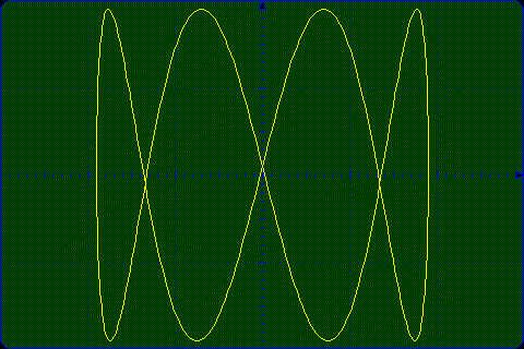

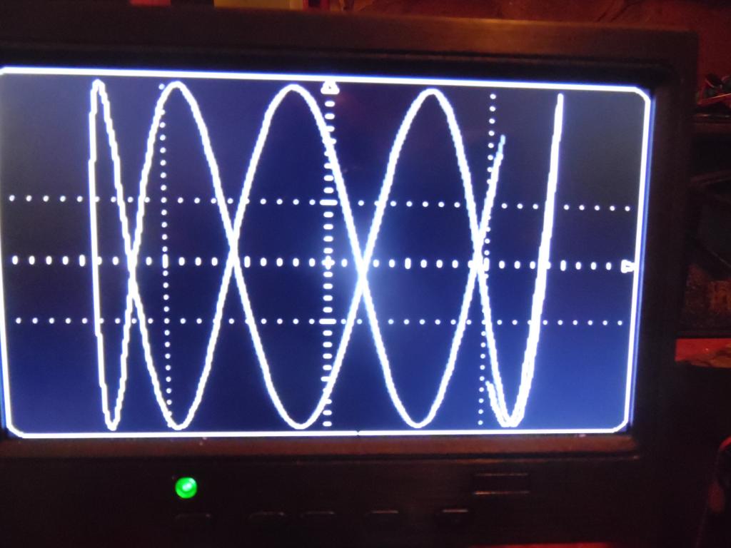

point is why the code works hdmi and vga but not 320x240 ili9341, read the manual and seems ok.
I did oscilloscope on same lcd with graticule drawn once and scope display on top and then send to the screen, ok.
the idea is draw the graticule once on a layer. I can do without the graticule and just the Lissajous. stan

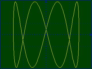

Replaced the ILI9488 with a ILI9341, allowing smaller framebuffers so 2 will fit in memory.
Messed about with layers etc till it worked with the graticule. Could not get the [,B] parameter to work properly with most of the Lissajous missing. Maybe that is only for the RP2350?
Anyway this works smoothly without ,B on a RP2040 so may be even better on a RP2350.

Posts: 3417
Posted: 11:36pm 11 Aug 2025
Another working version with comments
Option ANGLE DEGREES
FRAMEBUFFER CREATE
FRAMEBUFFER LAYER
RX=MM.HRES:RY=MM.VRES:CX=RX\2:CY=RY\2
Scale=0.95: AX=CY*Scale: AY=CY*Scale
a=1: b=0: p=0: f=0: c=0
FRAMEBUFFER write L '<===== Write the following to Layer L
CLS '<========= Black is the default transparent colour
Colour RGB(Blue),0 '<========== choose graticule colour
RBox 0,0,RX,RY
For y=80 To RY Step 80
For x= 8 To RX Step  8
Pixel x,y
Next x:Next y
For x=80 To RX Step 80
For y= 8 To RY Step  8
Pixel x,y
Next y:Next x
For y=0 To RY Step 8
Line CX+1,y,CX-1,y
If Not (y Mod 40) Then Line CX+2,y,CX-2,y
If Not (y Mod 80) Then Line CX+3,y,CX-3,y
Next y
For x=0 To RX Step 8
Line x,CY+1,x,CY-1
If Not (x Mod 40) Then Line x,CY+2,x,CY-2
If Not (x Mod 80) Then Line x,CY+3,x,CY-3
Next x
Triangle CX,0,CX-3,8,CX+3,8,,1
Triangle RX,CY,RX-8,CY-3,RX-8,CY+3,,1
FRAMEBUFFER WRITE F '<===== Write the following to Layer F
If p>360 Then p=0: EndIf
If b>6   Then a=a+1: b=0: c=0: EndIf
If a>5   Then a=1:   b=0: c=0: EndIf
If c=50  Then
 f=1
 If a=Fix(b) Then f=0: c=0: EndIf
EndIf
If c=130 Then f=0: c=0: EndIf
CLS RGB(Myrtle) '<= choose Background Colour from the RGB121 palette
'Print : Print " A="a: Print " B="b: Print " P="p
   sx= AX * Sin(p) + CX
   sy= AY * Sin(p) + CY
For i= 0 To 360
   x = AX * Sin(a*i + p) + CX
   y = AY * Sin(b*i + p) + CY
   Line sx,sy,x,y,,RGB(Yellow) '<= choose Foreground Colour for plot
   sx=x: sy=y
Next i
FRAMEBUFFER MERGE '<======== copy both layers to the screen
Inc p: Inc c
If  f=0 Then b=b+.02

Don't you want the plot on top of the graticule?
Posts: 3417
Posted: 01:19pm 12 Aug 2025
Ok, reversed the layers.

Posts: 3885
Posted: 01:47pm 12 Aug 2025
With no changes, on an RP2350A with ILI9488 LCD.

Posts: 2807
Posted: 05:33pm 12 Aug 2025
original listing looks like this mode 5 hdmi
