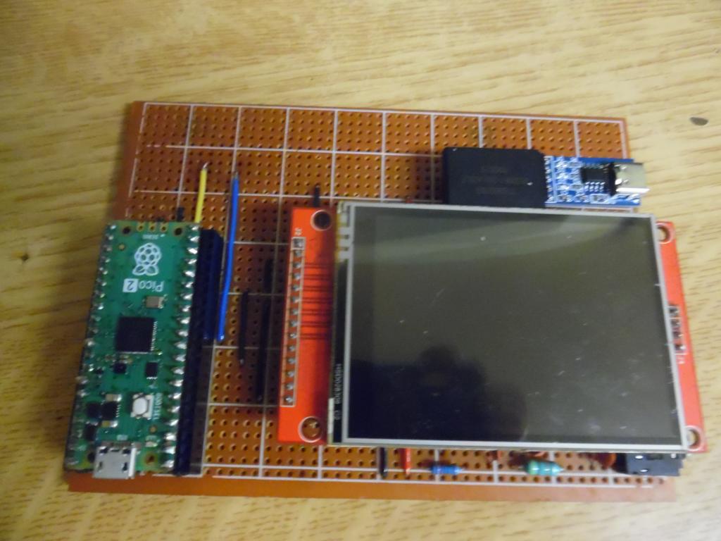

I'm not exceptionally knowledged with electronics, but I though I'd try building a couple Picomites using SPI ST7796S and 8 bit SSD1963_7 LCD panels.
The Picomite user manual has been super helpful, and I've found enough other basics references, so that I've gotten both panels connected and working with Pico 2's.  I have something of idea of where to go from there, but since I'm really an amateur at this, I wanted to see if anyone had suggestions about the best pin congratulations to use the panels, touch screen, SD card, PS2 keyboard, sound, and DS3231 RTC.
Because I tend write problems that are really heavy on file access, my inclination is to put the SD on it own set of SPI lines, as believe I've read the performance is better. I should have enough pins with the SPI display, but  probably not with the 8-bit one.
Also, is there something like a good "RPI for Dummies"? Im sussing out the GPIO pins, but I'm not entirely sure which can do exactly what.

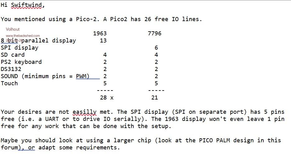

Hi Swiftwind,
P.S. On both designs, OPTION SYSTEM SPI could combine TOUCH and SD card, and thus save 3 pins. But I have no means to test if this works.

The Pin diagram I found the uses 12 for the 1963:
GP0-7 for TFT DB0-DB8 (8)
GP8 KB CLOCK
GP9 KB DATA
GP10 SPI CLK (T/SD)
GP11 SPI DIN (T/SD)
GP12 SPI DOUT (T/SD)
GP13 TFT RS OR DC
GP14 TFT WR
GP15 TFT RD
GP16 TFT RESET OR RST
GND  TFT CS
GP18 T_CS
GP19 T_IRQ
GP22 SD_CS
So, if I understand it correctly, for the RTC and sound I can use:
GP20 I2C SDA
GP21 I2C SLC
GP26 PCM-A LEFT
GP27 PCM-B RIGHT
So, with the shared system SPI, it would take 24 pins total for 8 bit version.
With the ST7796S version, again if I understand it correctly, there are two 2 SPI buses natively in hardware, so without redefining pins, I assume one solution is to put the screen and touch on one bus (GP2-4), and the SD on the other (GP10-13). Then the I2C on GP6-7, keyboard on GP8-9, sound on GP26-27, and the other lines on what's left.

Posts: 5994
Posted: 05:56am 27 Aug 2025
Pwm sound needs a pair of pwm outputs so needs mapping too.
Volhout.

Posts: 5994
Posted: 07:13am 27 Aug 2025
Hi Swiftwind,
Understood. So you have GP17 and GP28 free.
GP17 can be programmed as COM1:RX and GP28 can be programmed as COM1:TX.
So for expansion, you have a UART port free. That could allow for connecting a ESP8266 WIFI, or a GPS receiver, MAX3232 (genuine RS232 port) or MODBUS/RS485 expansion.
One thing you could do is:
GP26 I2C SDA
GP27 I2C SCL
GP20 PCM-A LEFT
GP21 PCM-B RIGHT
This would still leave GP17 and GP28 free, audio would use PWM2 channel, but I2C would map to I2C2 that you would connect to internal I2C devices like the RTC. Advantage of this new mapping is that GP17 and GP28 can be used as COM1, but also as I2C, since it is independent of I2C2.

Hi Swiftwind,
just to mention, having Touch and SD sharing a SPI bus works very solid for me with a SSD1963. The circuit to make it possible to combine CS works very solid as well.
SD can be configured to any pin combination and does not necessarily match hardware SPI GPs. I've tested it with a 2350 and I/O speed is almost the same.
The SSD1963 I have configured: GP0-15 8/16bit and GP16-19 for RS,WR,RD and with option "noreset"
