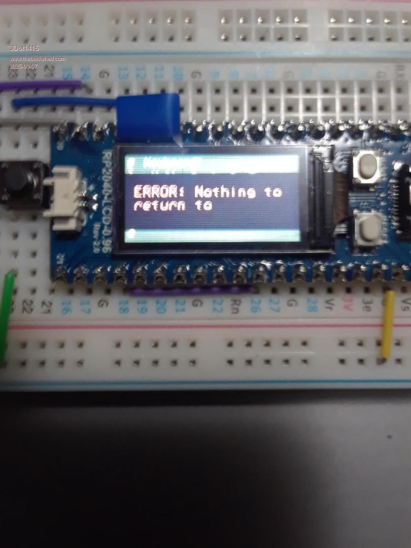

per Steve Johnson project, verbatim.
Then I transferred Picoscope.bas. Screenful of errors, but the last two lines went to LCD so it works.
Error : Frame buffer not created
>   FRAMEBUFFER COPY F,N
> End Sub
Error : Nothing to return to
> clearTerminal done
Need more Help please.

I don't have a Waveshare RP2040-LCD-.096 board so loaded the PicoScope program linked to in my previous post to a  RP2040 / ILI9341 setup with firmware PicoMite MMBasic RP2040 V6.01.00b11 (the latest beta version).
After changing the pin assignments to suit the different hardware it works without error, so I don't know what the issue is. It may be a bug in the firmware version you are using as @MatherP has fixed one or two recently.

I think it's a file transfer issue.
XMODEM freezes
If I use send file instead, with 300ms per line delay I can see the program scroll
across the LCD. About halfway thru the PicoScope displays on LCD with button choices
but then is partially covered by scrolling code.

3Dot1415
Joined: 06/09/2025
Posts: 5
Posted: 06:15am 07 Sep 2025
You can see scope in background.

Perhaps Autorun is the problem. It sounds like it is starting to run the program before it has finished loading.
Set OPTION AUTORUN OFF until you have everything working properly. F2 starts the program from the command prompt and Ctrl-C stops it.
The method I used to load the program was to copy all of the program to the Windows clipboard from the code box in the TBS link I mentioned. Then use AUTOSAVE (in TeraTerm at the MMBasic command prompt press F10) then press Alt-V to paste the code. When it stops scrolling press Ctrl-Z to save it. F2 should start it.
Edit.
You posted while I was typing, now I see.
Error messages go to any attached screen so they can be seen in embedded systems not connected to a computer.
Perhaps a Subroutine is trying to return to the main program and failing.
Maybe part of the program is missing. Set OPTION AUTORUN OFF then try reloading the program, or press F3 to List it in TeraTerm and compare it with the code in the link.
