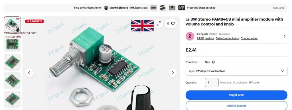

Very cheap.
Mono only, but ideal for adding cheap(VERY cheap!) audio to your MMBASIC projects.
AMP...
This is your classic LM386 configuration, but if all you need is basic sound effects or voice prompts on speakers etc, this is your guy.
Works VERY well, gives plenty of volume for what it is.
Hi-Fi this is NOT, but.....
Complete with volume control and knob, 3.5mm stereo input socket, and PCB T-block for power and speaker connector.  Pretty good value, I think.
As I say - NOT HiFi, NOT stereo, but perfect for simple sound stuff.

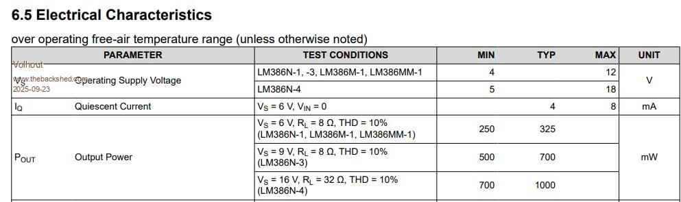

LM386 cannot provide a lot of power when powered from 3V (3V3), this advertisement is a big lie.
- use 5V minimum
- 12 watt... NEVER, 1 watt is more likely.

In my latest design I've used the PAM8406, stereo in a single chip and almost no external components - class D/AB selectable. I'll report more when the boards arrive.

I use this in combination with picomite. Powered from Vsys (4.5V) but it runs from 3.3V as well.

  Volhout said  Hi,
Who said I was powering mine from 3v3?
I'm using 12v for the amp module, rendering around 500mW or so of output with relatively low distortion.  I tend to ignore any of those output power figures, when they state a distortion of 10%, cos that's a hellishly high distortion figure!
As per the claims in the listing - yeah, they often lie, but I am trained to ignore anything they say in the tech specs side of most of those listings now.  Locate the main device - LM386 in this case - then use the authentic device datasheet, so as you say around 1W maximum at about 16v with 10% THD, so certainly not Hi-Fi as I mentioned, but perfect for sound effects etc.
But using 12v for power.
