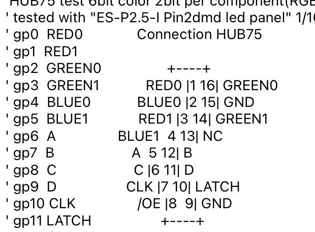

Are all/most of those Chinese 64 x 16 panels compatible or do I need to look at specific models?
How is the wiring connected from the Pico to the panel? Ie. pinout.

Posts: 3416
Posted: 01:38am 27 Sep 2025
The comments at the start of his code show its socket pins and the model to search for.
'HUB75 test 6bit color 2bit per component(RGB)and some fill bits = 1byte      |
' tested with "ES-P2.5-I Pin2dmd led panel" 1/16 scan from Ali-Express
' gp0  RED0              Connection HUB75
' gp1  RED1
' gp2  GREEN0                 +----+
' gp3  GREEN1            RED0 |1 16| GREEN0
' gp4  BLUE0            BLUE0 |2 15| GND
' gp5  BLUE1             RED1 |3 14| GREEN1
' gp6  A                BLUE1  4 13| NC
' gp7  B                    A  5 12| B
' gp8  C                    C |6 11| D
' gp9  D                  CLK |7 10| LATCH
' gp10 CLK                /OE |8  9| GND
' gp11 LATCH                  +----+
' gp12 /OE
' The reduction to only 6bit was usefull to minimize the time for preparing
' display-data (pack and mix now~1ms), The PIO would be quick enough for more!
Posts: 2982
Posted: 01:53am 27 Sep 2025
Hi Phil,
Thank you,
That makes sense, I read the bas file on my iPad and the screen looked like this.
Which wasn’t obvious as a pinout.. your view is very clear.

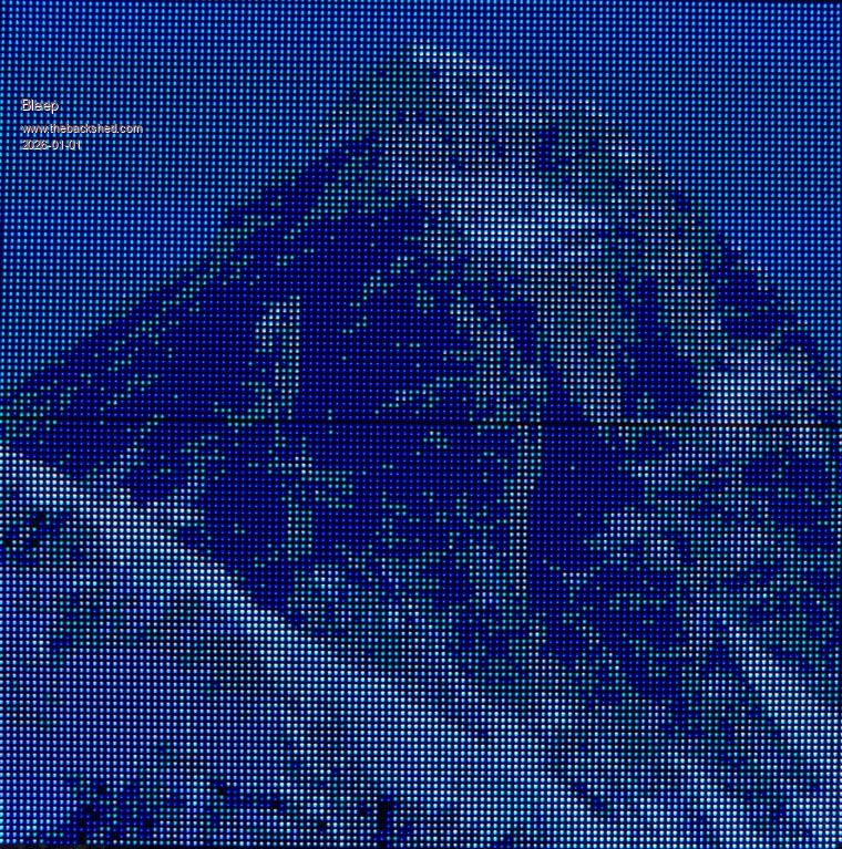

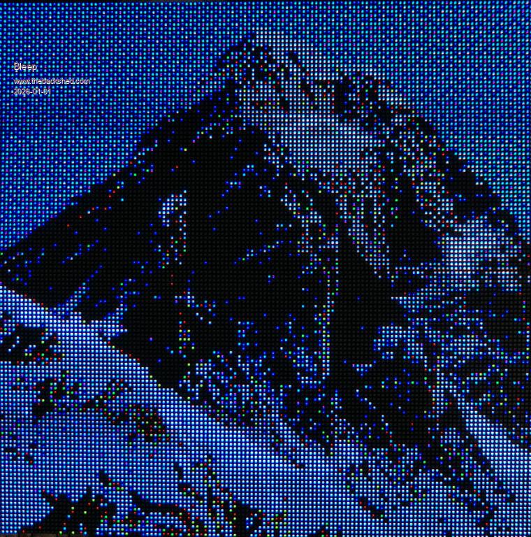

A new version with RGB332 1byte 256 colors, therefore an other connetion plan
prepared for greater displays with 1/32 scan
with a 16er proportional font for text, from my ws2812-project.
Hub75_256.zip
Albert

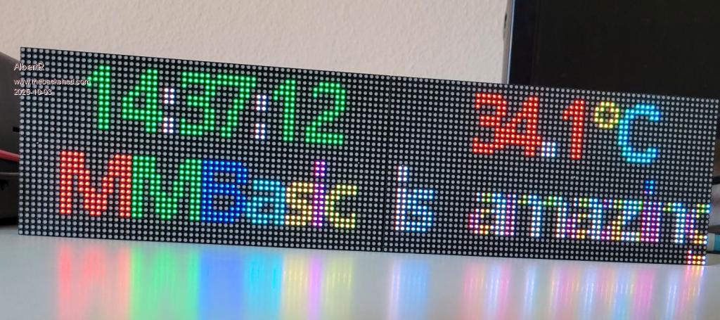

The shown display are two of the 'ES-P2.5-I Pin2dmd' led panel. As shown in the name it has a 2.5mm Pitch, with 128x32 pixel -> 320mmx80mm.

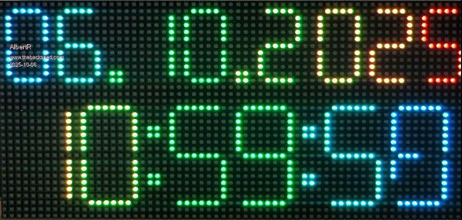

This time a little smaler,
a first little application, or usefull demo for the display-driver (32x64) and only 6bit color.
Inspired by the "Morphing Clock" for this Hub75-panels, I ported it to MMBasic. I have no idea if this has ever been done before.
The animation is not from me, see header in the source. I only changed the code from C and adapt it to my display driver. Very simple and not optimized, I thing for playing with it.
MorphClock.zip
Albert

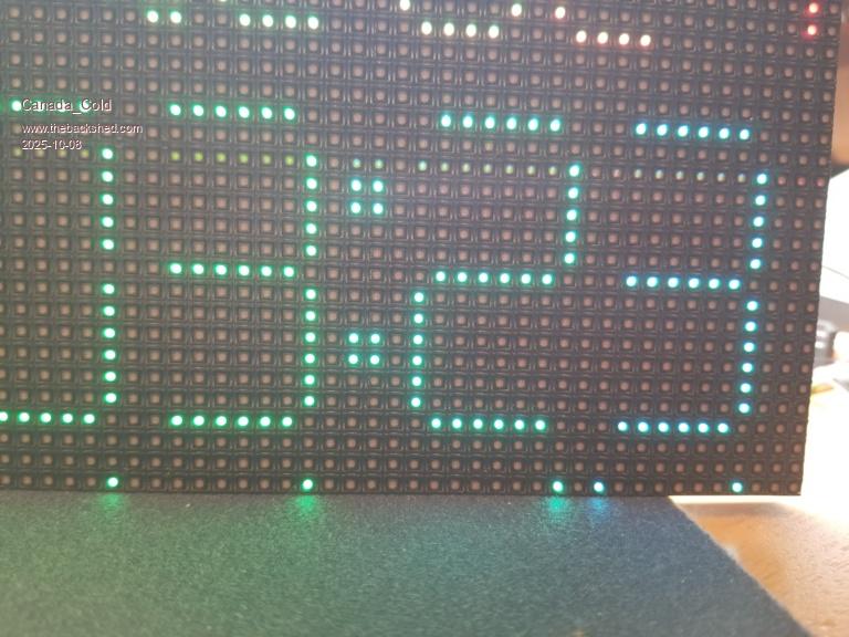

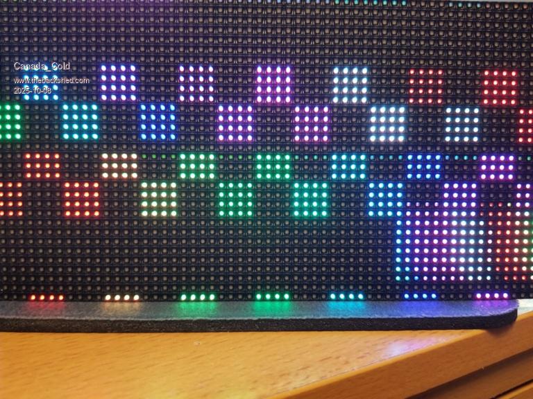

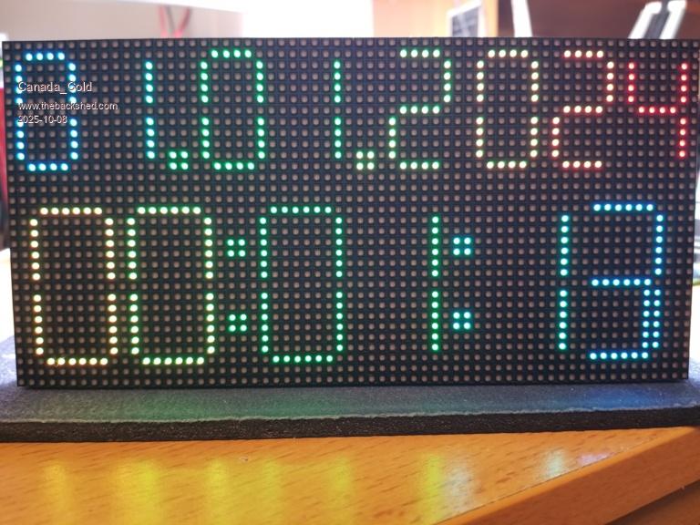

Hi Albert,

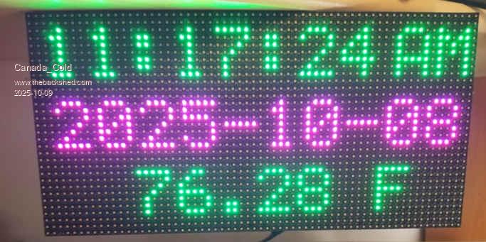

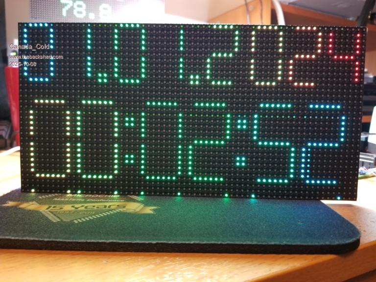

I ran your demos and the clock on a P2.5 and P3 display and they ran great.   However when I tried them on a P4 I get this odd display where line 16 is on line 32.  See the following:
I’m assuming this is a timing issue as the P4 display works with the MicroMite Plus code posted by matherp (Posted: 09:45pm 28 Jun 2016) and the Python code on the WaveShare website.  BTW, all of these displays are from WaveShare.
I have tested the P4 display with a PicoMite2040 and a PicoMite2 2350, with the same results.
I have one other P4 display (not from WaveShare), however it is being used in a clock display at this time.  I’ll have to dismantle the clock to test your code on it.
The following picture is your Clock running on a P2.5 display.

Hi Don,
Thanks a lot for your feedback. I'm glad it worked out for you.
I was afraid it would be useless.
Also that you tested so many displays. I have only two P2.5.
The 32x64 displays has a 1/16 scan and the line in the middle(line 16) has address 15 and the line at the bottom has the same. The data is output in parallel at the same address. The data is only offset.
It's strange that despite the timing problem, the color has remained the same.
I have a problem with PIO-DMA where the TX interrupt stops the PIO even when data is still being pushed out. I had actually added the dummy bytes to the length for this purpose. Peter thinks the PIO is too slow.
But if it is faster, it generates many interrupts that have to be handled, PIO init, and restart. This reduces system performance.
Increase the number of dummy bytes.
Then you have also to increase the arrays-size of PacA and PacB.

Canada_Cold
Joined: 11/01/2020
Posts: 57
Posted: 08:37pm 08 Oct 2025
Hi Albert,
Your code is very impressive and I’m sure anyone that wanted to work with the Hub75 displays would find it very useful.
I did make the changes you listed, however it did not make a difference to the operation of the P4 display.
To rule out any problem with the P4 display I hooked it up to a clock that I built using the code created by Peter (matherp) back in 2016.  See the following.  The picture is not the best, as the display is very bright and it over whelms the phone camera.
If there is anything I can do to help with testing/debugging your code, I’ll be happy to do that.
