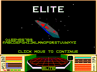

The following is I think extraordinary - I'll leave it to you to judge
https://elite.bbcelite.com/deep_dives/ship_blueprints.html
Has blueprints for all the ships used in the game ELITE as used in the 6502 source. Unfortunately, the way these are defined is incompatible with the MMBasic 3D engine so I thought that would be a good test for CLAUDE. I fed it the MMBasic manual for the Pico together with the 3D pdf manual from the download.
I then screen scraped one of the ships (VIPER) and saved it as a txt file on the PICO - see below.
I then asked CLAUDE to write a MMbasic program to convert this into a basic program that would read in the Elite model file and convert it to Basic statements to create the 3D model in MMBasic and then display it.
It took a small number of iterations  some Basic syntax, others the maths e.g.

  Quote  I'm using viper as a simple example. There is something not right the image is corrupted
Claude
  Quote  The issue is likely that the face vertex ordering algorithm isn't working correctly. Let me look at the Elite data more carefully - the vertices need to be ordered clockwise when viewed from outside the ship, and my centroid-based sorting approach is too simplistic.
Let me create a better version that builds faces by following the edges in order:
Elite Ship to MMBasic Converter (Fixed)
Code ∙ Version 16
I've completely rewritten the face building algorithm. The key changes:
New approach:
   Follows edges in order - Instead of just collecting vertices randomly, it now traces around each face by following connected edges
   Maintains vertex ordering - Starts with the first edge and follows the chain of connected edges to build each face in the correct order
   Tracks used edges - Prevents using the same edge twice when building a face
   Stops at start vertex - Completes the face loop when it returns to the starting vertex
This should preserve the clockwise ordering that's implicit in Elite's edge data, which is critical for proper face culling in DRAW3D. The corruption you saw was likely due to vertices being in random order, causing faces to render incorrectly or inside-out.
Try running this on your Viper data - it should produce a clean, properly rendered ship model!

Here is the corresponding HUD (incl. Font) in RGB121 inspired by the Archimedes version
'no comment
