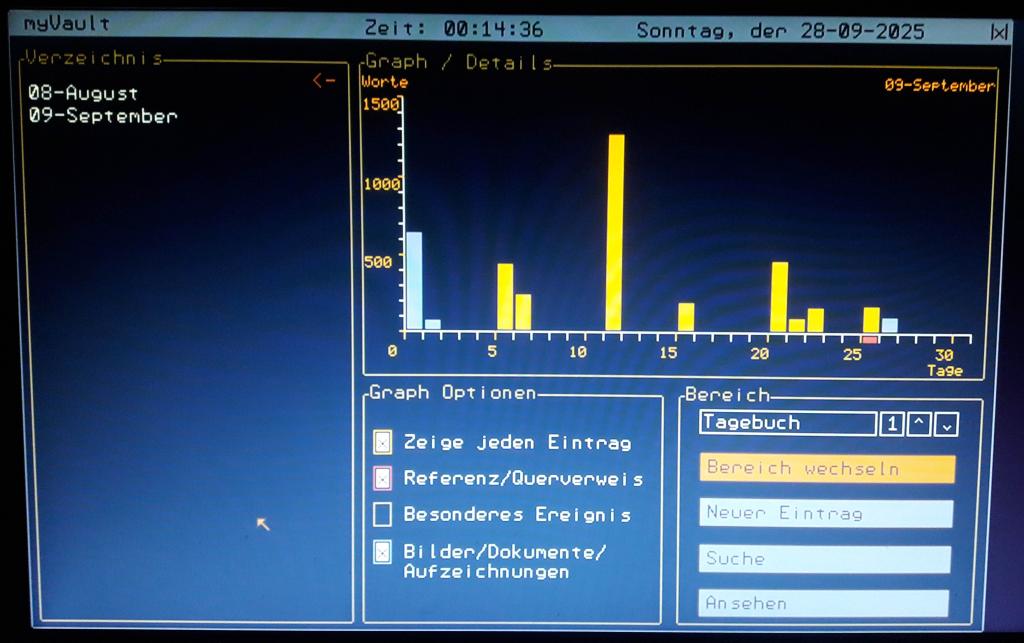

Hello all!
Maybe this is more a question for Peter, but maybe I am blind and anyone knows a solution.
I am heavily working on the translation of my journal/diary program including GUIs for the PicoMite HDMI (USB!) version, because I started this project in pure German.
The Problem: I was using the PicoMite HDMI PS/2 version, in this version I am able to
read in the raw ASCII value via the command:
MM.INFO(PS2) '(Reports the last raw message received on the PS2 interface if enabled.)
Why would I do this? Simply because this allows me to read in the raw key of German Umlaute (ÄäÜüÖöß) and map then to a custom font made by Martin, which has all the German Umlaute in it.
So for converting this already huge program, I have written, to the USB version, I desperatly need to read in the raw USB keys of those Umlaut-Keys, too. I can't find any command for this. I was optimistic that:
keyDown(n)
will do the trick, for the USB version - but it doesn't show anything when I press on my German Keyboard "ÄÜüÖöß" - so there is no solution for me, to translate my software for the German USB version (and after that to the english USB version).
I really hope there is a solution for that, if not I have to stick to the PS/2 version - which is ok, but sad, since Peter fixed the missing keys on the USB version many iterations ago
Only for the interested, a short program description:

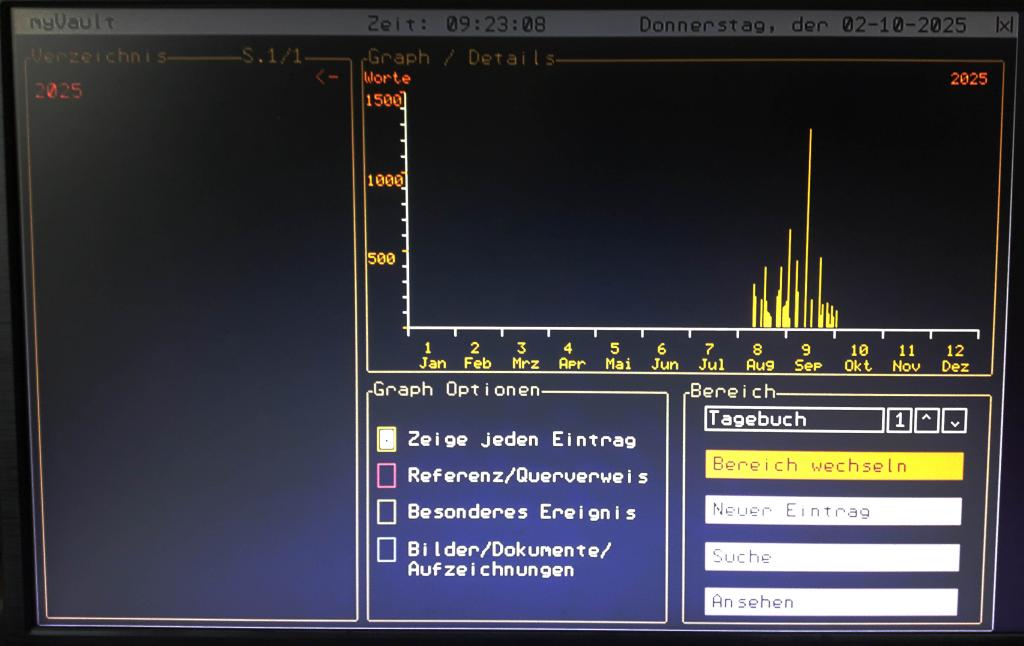

Here are some images of the already finished (german version) of my diary/journaling
software, it also includes a text editor, excessive graph options to show different parameters. And it doesn't stop there: you have in fact three different working areas:
diary/journal = German = "Tagebuch"
health        = German = "Gesundheit"
notebook      = German = "Notizbuch"
in every area (German = "Bereich") you have different visualisation parameters for the graph. For example you can track your: pulse, blood pressure, stress, words you have written on the specific entry, and you can even add own comparison parameters.
There is a search function, which allows to search a whole month for specific words.
The program is split into six different (chained) programs.

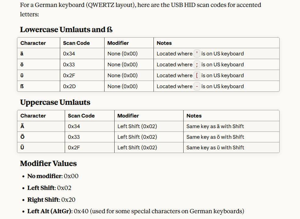

If you provide a list of the USB scan codes for all relevant keys and required modifiers associated I will see if I can do anything. I just need all the required unique pairings I don't care what they mean
e.g.
code modifier
0x87  ALT
0x87  none
Posts: 12059
Posted: 10:48am 03 Oct 2025
Is this correct
Amnesie
Joined: 30/06/2020
Posts: 763
Posted: 07:57pm 03 Oct 2025
Hi Peter,
Sorry for my late respond, just came home.
Yes your list is correct. For example, If I type in your test-firmware via:
Print MM.USB (and pressing "ü")
I get: 47, which is "0x2F"
Etc...
Would be Amazing , if you could work something out for a simple solution or some function which acts like MM.info(ps2)
If you need some more testings or info, I will do my best.
Greetings
