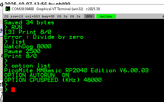

I have discovered that neither the HW watchdog, or the software one work if you slow the CPU clock down to 48000 - this is a problem.
Test code is in this image, but I set the software watchdog to 8000, then force a crash/bug via a divide-by-zero command.  The PM never restarts, with either the software OR hardware watchdog command.  It just sits there forever, and I can come back minutes later, and still access the console - but the watchdog is NOT firing(either type) with the CPU clock speed set to 48000.
EDIT: OK, Watchdog IS working if I replace the divide-by-zero command, with a simple DO:LOOP - that done, both the HW and the software watchdog work.  Both at the default CPU speed, and also at 48000.
But I thought that the watchdog was ALSO supposed to kick the CPU, if there was a bug in the code(such as my divide error) that dropped the code back to the command prompt?
That's the kind of error I need to trap - if the code runs into an error and drops back to the command prompt for whatever reason.

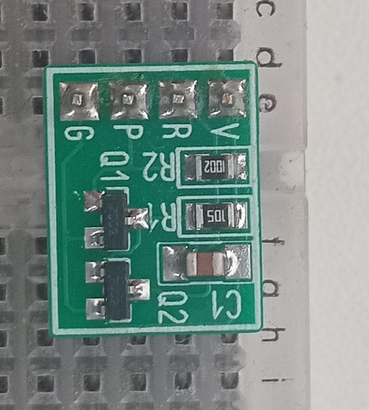

Watchdog is always a concern for me. I don't really want the MCU to restart but I want the plant to shut down.
Was looking at these
There are others from different manufacturers.
Posts: 8965
Posted: 06:37am 07 Oct 2025
For plant control you are better with a crude system. Pulse from the Pico, via a capacitor so it doesn't matter if the output gets stuck, retriggers a monostable that cuts IO power if it times out. You may need a second monostable to allow the Pico to boot in the first place. It's usually safe to just kill all power, but not always! External watchdogs are the way to go. A dual 555 would be fine. True and tested, with no micro content.
