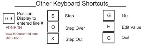

Please note:   You need a VT100 terminal attached as the console to use the debugger.   You need to be able to type commands on your keyboard and have the PicoMite respond to your VT100 terminal.

That is a good idea.    In the meantime, if you load up the 10 Minute Tutorial it will let a person see all of the important features the debugger provides as it steps through the sample program.
And the 'Cheat Sheet' does let a person see what it looks like and how to do various things within the debugger.

2/ After I tried modifying a variable value, it was not obvious how to exit the window.
  ... until I simply clicked outside the variable edit window.
The planned and designed method to close out and leave the 'Edit Value' command box is to
give it an 'Enter' key with nothing else at the command prompt.   Depending on what
happened with the last command that was given, that can be a single 'Enter' or it might be
three 'Enter' keys in a row.
I understand that is a little cryptic at first.  But I am open to suggestions and once
a person gets trained to just hit a blank 'Enter' command it is pretty quick and natural.
Perhaps making a Mouse Click anywhere outside the 'Edit Value' box to 'unfocus' and remove
the box is the right way to handle that?    Or perhaps, recognizing either a blank 'Enter'
or Mouse Click outside the box would make more sense?
I'm more than willing to alter this behaviour.   Let's get some more discussion and figure
out what the community gravitates towards as the 'answer'.

2/ I like closing the variable edit window with mouse click. I only did not know until I tried.
OK.  I'll figure out how to make that 'official' and always cleanly exit the window.

Hi EDNEDN,
Great work,
I'm also impressed by how it's implemented in the terminal.
Until now, I've always used “printf” debugging and also tried using ‘stop’ as a breakpoint and “continue.” But that only works in the main program. Also, only global variables can be “printed.”
So, everything's great for me! I had never dreamed that this would be possible in MMBasic.
You already evaluate keys for changing the width and height, maybe you could also add a key for “step”. With the mouse, I think you have to concentrate more on hitting the button, but with the key, you can just leave your finger over it.
What is the preferred transfer method for the programs? Up to now I used XMODEM, but I had problems with the debug version. The progress stopped after 512 Bytes
Albert
Ultimately, we probably need a full manual.  But in the 'Cheat Sheet' it says:
I typically use MMEdit (and MMCC) to get stuff moved onto the Pico's.   If you load the MMBasic program into MMEdit, you can just click the transfer button to move it.  But MMCC is a little buggy on the transfers.   It does lockup sometimes.   The other thing you can do is use TeraTerm and from the MMBasic command prompt say > Edit
At that point you can cut and paste MMBasic programs.   But you need to tell TeraTerm to 'Paste things slowly' with line delays.
