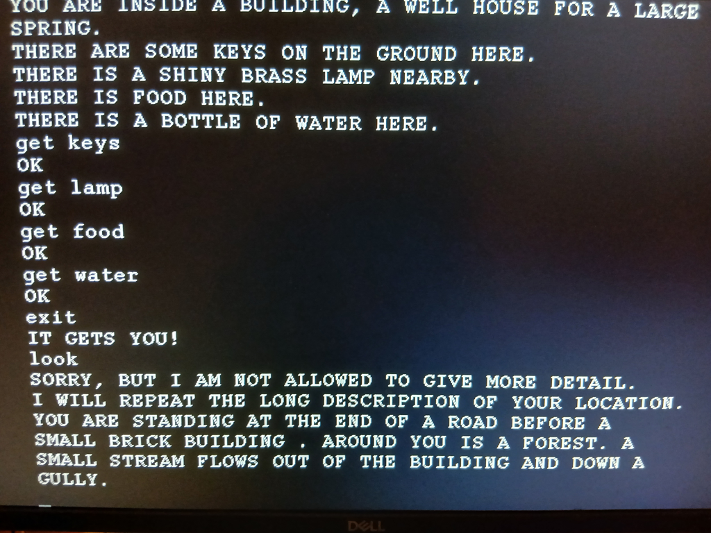

It is working. But the commands are very different from Tay's. I may have to decode (it is a ROT-13 cypher, like used for GeoCaching) to learn the verbs.
It does not know "Inventory" or the likes..

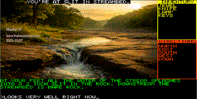

As shown in the image, the GUI version will have a field displaying what the user has with them.
The images are almost finished, and I will then try to integrate the GUI into the text version of the adventure.

There have been several versions. "inventory" was certainly recognised in at least one because I hated having to type such a long word! "inven" was also recognised.

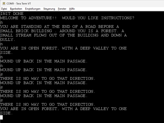

I hope you have stamina... There is a long way to go.
1/ start new game. press "n" 2x -> error in line 293.
  at many locations in the game pressing "n" several times causes the same.
2/ There is a note about "winding roads" making navigation not logical, but the navigation on this one is very strange. Start new game, go "w" -> up the hill.
There is no way to get back to the starting point, after a bit of trying, you are under ground (walkin in the forest -> main passageway). Without any notice you are entering a cave.
Maybe 2/ is as intended in the game, but to me it feels awkward.

  Quote  1/ start new game. press "n" 2x -> error in line 293.
Ive done a lot of debugging, this should be Fixed.

The pictures are beautiful.

Pictures "a69.bmp" and to a lesser level "a71.bmp" use a different colorscheme. They do not match the rest of the pictures. Maybe that is intended to be.
I like "titel.bmp" better than "titel2.bmp", but that is obviously matter of taste.
Looking out for the implementation of these graphics in the game. Really exciting !!
