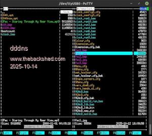

Hello!
It was open in a tab in my editor and I haven't touched it for months. Now I found the time to add the for me missing peaces. I have just finished it and it isn't fully tested but looks very good.
So this is, with many thanks @ Javavi for his nice code, a minimal version of his FM172. I added and modified some lines and deleted all I don't need.
The changes:
it runs on all platforms in colour
it resizes putty and leaves a clean screen when closed
uses only characters below 128 so looks good in every constellation
all Coulour calls are replaced by a sub routine call
the subroutine sets the colour for console and/or screen
the terminal size for console only can be set with a variable at the beginning
colours for cursor and F-keys can be set with a variable at the beginning
replaced the ISR to set the time
clears the input buffer for inkey$ so cursor stops immediately
added a keypress_delay variable because it's too fast now.
Runs perfect on my ssd1963 LCD on a RP2040 (which was the major reason doing it)
This is a one time work I don't want to follow up because it runs good enough for me.

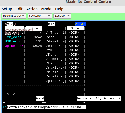

Works nice on my 2040 VGA system, on both terminal (putty/MMCC) and VGA screen.
You have removed some functions, okay for me. The only remark I can make is that when closing the filemanager, on the VGA screen there is "[7 [2J [H". Probably data that is send to the terminal, but also shows up on the VGA screen.
Maybe you can shorten line 30 with INSTR(MM.DEVICE$,"HDMI") or INSTR(MM.DEVICE$, "VGA").

No, you did not fix the issue. The problem is that you are defining a few constants, and then change to mode 1 (MM.HRES etc.. change)
If you are in mode 2 when starting the miniFM you get this (both VGA and console(both Putty and MMCC)):
My changes fixed that.
Edited 2025-10-15 05:41 by Volhout

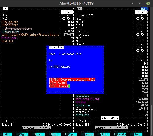

I spent the last days to get it complete.
The changes:
- the init routine is complete
- the main loop is done
- dialogs are rewritten and done
- dialogs and everything is centered
- dialogs have an option for confirm, "yes to all" and cancel
- you can set behavior for confirm and overwrite
- Everything scales correctly from 5 x 37 to 100 x 240 characters terminal size
- on VGA and HDMI in all Mode 1 resolutions
- Took special care for LCD and it should run from ILI9341 320x240 to any.
- On LCD you can chose any system font
- code cleanup and formatting
There are still minor cosmetic issues.
Error handling is not done yet
I haven't touched the backend subroutines at all. All I can say is that they run super stable and deliver correct answers.
Please test this and comment!

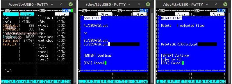

minifm_RC.zip
smallest possible, here 40x20 like on a ILI9341:
Standard 80x24:
'Custom variables-----------------------------------------------------
 Dim integer confirm_each = 1 '0:Don't ask, 1:always ask
 Dim integer overwrite = 0 '0: alwasy ask, 1: don't ask
 Dim integer run_bas = 0 ' disable Enter to execute .bas file
 Dim integer lcd_font = 1 ' 0 to use system setting
 Dim integer tty_console_row = 24 'terminal height, min = 5 max = 100
 Dim integer tty_console_col = 80 'terminal width, min = 37 max = 240
 Dim integer cursor_colour = 7
 Dim integer fn_colour_bc = 7 'F Key colour
 Dim integer fn_colour_fc = 0
 Dim integer clock_bc = 14
 Dim integer clock_fc = 3
 Dim integer keypress_delay = 20 'in mSec
 Dim integer DnFColor=0  'Dirs & Files Color (0=Colorer ON)
 Dim integer SelColor=14 'Color of selected files
 Dim integer RMAX=199    'Max number of Records in File List (255 max)
Edited 2025-10-20 00:28 by dddns

ps: dialogs are rewritten means, that copy, move and delete are done with one consolidated subroutine. So this definitely has impact. Please test it.
E.g. It does no error handling and prevents to copy a directory into itself on the same drive.
