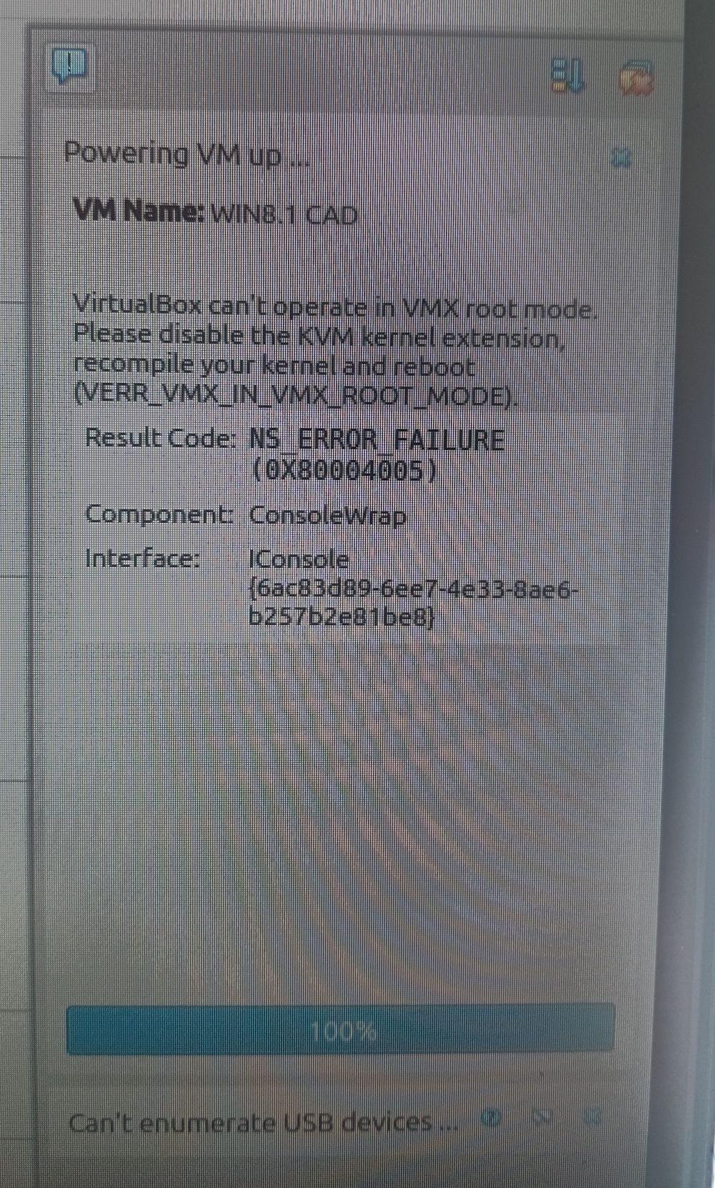

Playing with Mint 22.2, and trying to setup a VM for me to play around in, but VB won't start the VM.  I keep getting errors that I have to RECOMPILE THE KERNEL!
WTF?!
Here is the message I am getting:
VB version 7, installed via Software Manager.

I have VB installed on Mint, and I have setup a new VM with a Windoze 8.1 ISO image, but when I try to boot the VM and start the Windoze setup inside that VM, I get this "Aborted" error saying to recompile the kernel.
I assigned the VM 4GB of RAM and two of the CPU cores, which should be plenty.
So, the problem is that I can't get the VM to even boot inside of VB, cos the error comes up.  I WANT to be able to setup a Win8.1 VM inside of VB on Mint, to play around inside of that with my CAD software.

OK, I found this post on the VirtualBox forums:
  Quote  Hi, it seems you were having the same problem as me.
For me, what I had to do was unload the KVM module from Linux - it seem VirtualBox and it can't coexist in peace.
I ran these commands from the terminal:
sudo modprobe -r kvm_intel
Best wrishes!
I'm tempted to run those commands, but would like a 2nd opinion from the members who use Linux a lot.  I have to research what the KVM module is, cos my first in-head translation was "Keyboard-Video-Monitor" - a KVM switch.

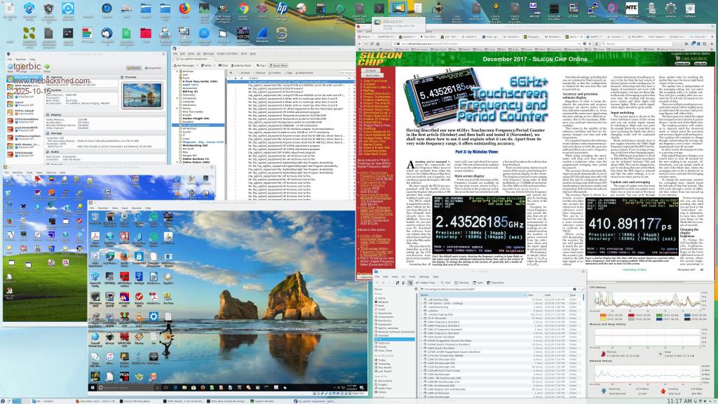

For those who don't run VMs and WINE, here is an old screen shot taken in 2018 to give an idea what you can do. Someone did not believe you could not run Linux, Windows10 and WXP at the same time in the same display screen.
If you look at the icons along the top there is a mix of linux and windows apps that run in the linux environment seamlessly. The windows apps run as if running natively in windows.
The background program (OS) is Fedora Linux with the Plasma desktop environment, running on an AMD MB. Fedora is running Firefox, Thunderbird (email), Dolphin (file manager), and the old KDE system monitor (bottom right). Some windows are Windows 10 (bottom middle) and Windows XP (bottom right) running in VirtualBox VMs. The upper left shows the VirtualBox manager with a list of VMs (mostly work applications). The display is a 4K Visio TV driven by an nvidia Gforce video card.  Sometimes I will also run Winamp in WINE for a music player and Irfanview in WINE for pictures/photos editing. Teraterm also runs fine under WINE. As long as you have enough resources and screen real-estate, you can run lots of things concurrently/seamlessly.

Correction, WXP is at the middle left. The Plasma desktop can be made to operate very similar to the windows desktop so the different OSs operate almost the same.

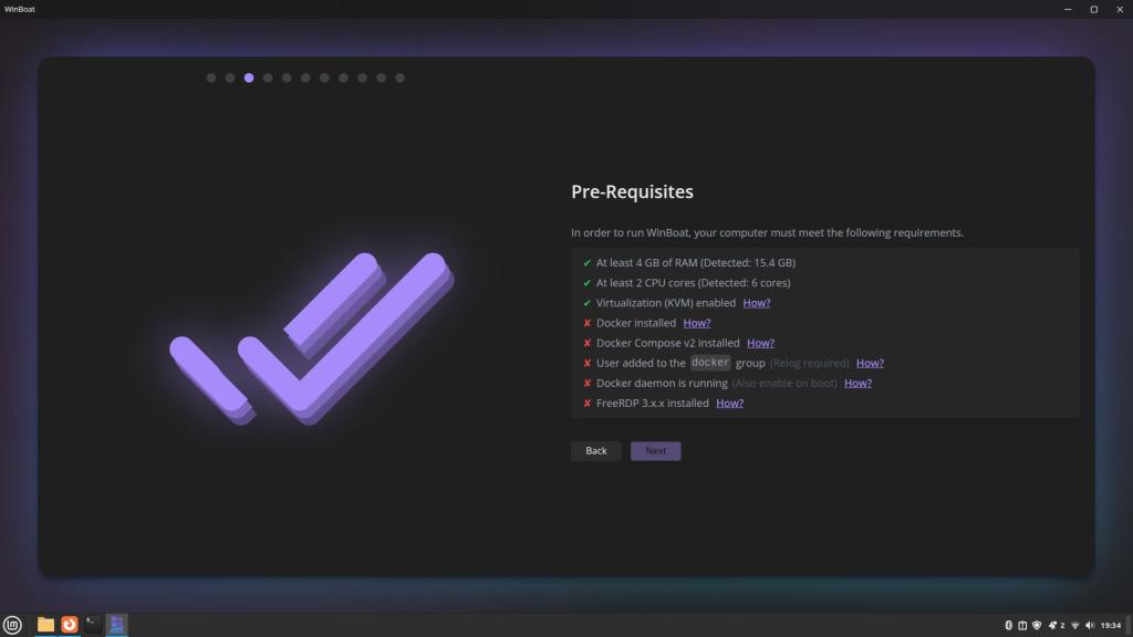

I just realized I was using standard Mint, when I wanted to play with LMDE6, so I have wiped the install, and put LMDE6 on the machine instead.
I have also been reading about "WinBoat", which seems to be a nice very easy to use kind of hybrid VM and WINE thing, so I have downloaded the .deb file for that, and will see if I can install and run that.

Just noticed how poorly the image was compressed by the forum software. You will have to imagine a crystal clear 4K display.

Yes, I just tried to install WinBoat via the .deb file, to be told it was already installed.
I did not know that!
So, I already am going through the motions of the WinBoat install process, on LMDE6.
So far, this is working just fine, and no issues with VB and setting up VM's.
I'll post back here, if I have success at the end of it.
Posts: 10074
Posted: 05:55am 15 Oct 2025
D'OH!
Issues already.
But I LIKE the GUI for this thing - and it very helpfully gives me "How?" links to follow, for the things it wants me to do before I can proceed.
Many a Linux distro or application before, would simply quote some crazy error message that means NOTHING to someone trying to migrate to Linux from Windows.  At least with this, you have LINKS you can click, that tell you what you need to do to satisfy the pre-requisites/dependencies.

In the same thread on the VB forums, they give an example of how you can "Blacklist" the KVM module, and seems simple enough to do:
  Quote  The error in your log file VBox-log file text 2.txt points to the KVM Module still being active on the host running Vbox with kernel version 6.12 or higher.
If the KVM module is not disabled, your VM's will not start. The version of Vbox is in this case not relevant
The file /etc/modprobe.d/blacklist.conf is already there on your Ubuntu system an should not be created but edited. Chech the path to that file. Edit it adding the lines
# disable kvm-intel for vbox
blacklist kvm_intel
and then reboot the host.
