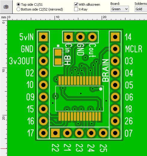

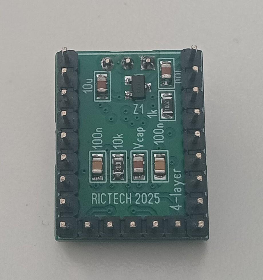

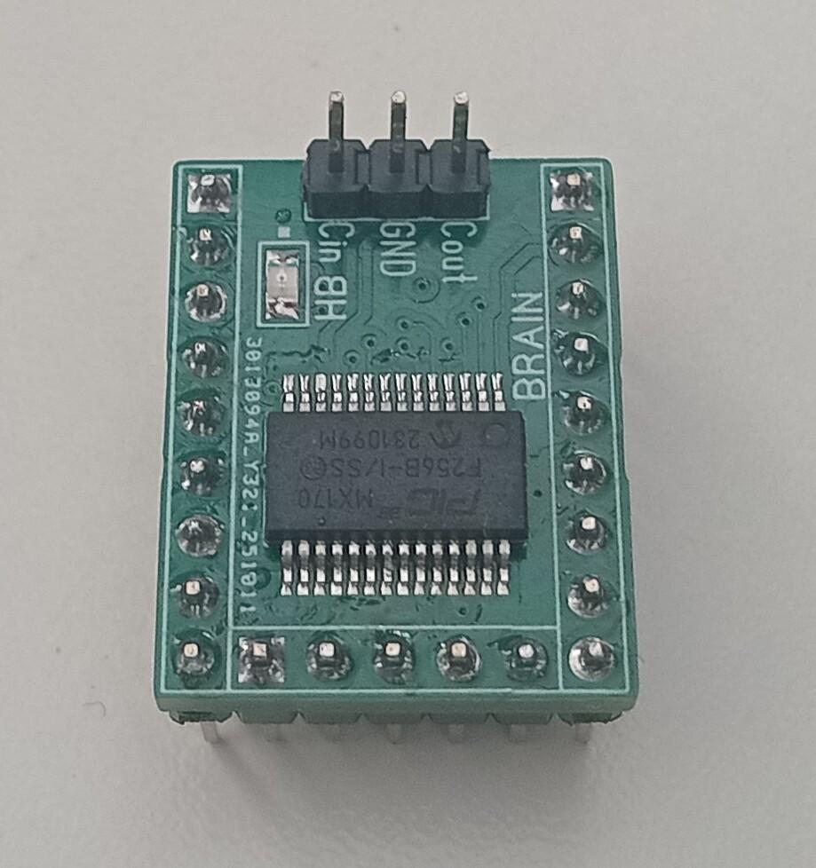

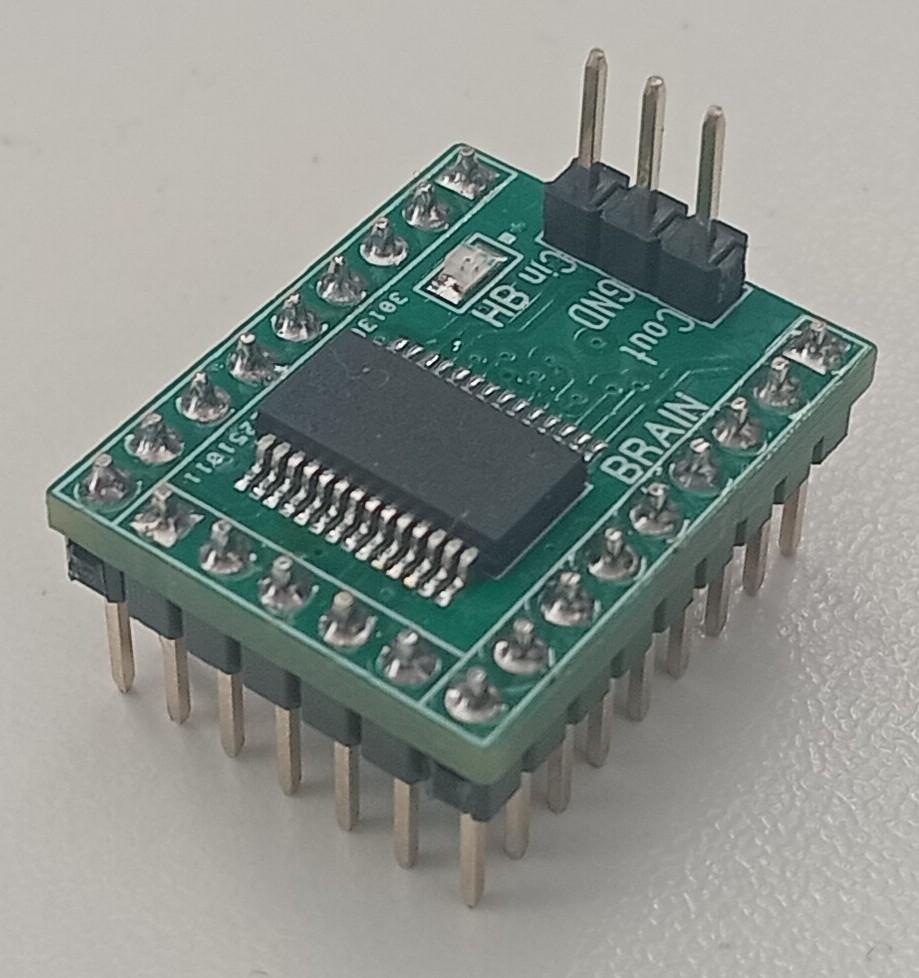

Hello everyone.
Following on from my other thread about Watchdog problems when using the WS Zero module and the PM firmware, I hereby show-off my version of this module.
The footprint is exactly the same, but the I/O numbers are different.
This new design is based on the classic MM2 chip, that being the PIC32MX170F256B, and is programmed and used in exactly the same way.
Certain I/O pins on the 170, needed to be on certain pins on the footprint, which is why the pin numbers are a bit all over the place. This board is 4-layer.  Not possible to do on two layer with the size restriction.
See my other thread for reasons as to why this came about.
I will be getting a few of these made, so if anyone is interested....

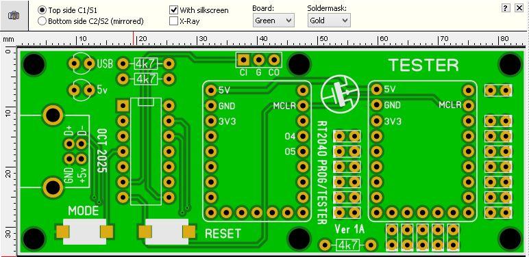

Programmer/Tester PCB:
Posts: 10074

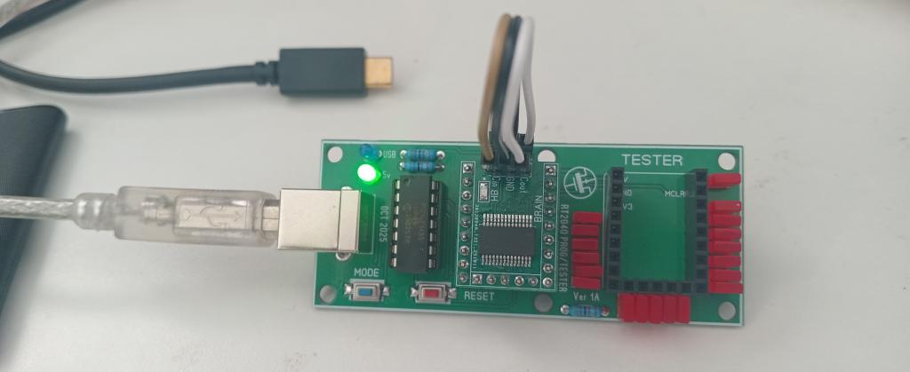

Posted: 04:59am 31 Oct 2025
Programmer assembled and working.
I just need to write a little test code, for the TESTER side of the PCB.
The idea being, that you program the module as a first step, and then move the module to the TESTER socket, and run the test code, which just steps through all the I/O pins, that each have an LED on them.
I am using one single resistor for the LED's, cos I plan to sequence them as the test, so only one will "ON" at any one time.

Test code:
  Quote  OPTION EXPLICIT
OPTION DEFAULT NONE
DIM B%(19)=(00,02,10,09,15,16,17,22,21,23,24,25,07,26,18,06,05,04,03,14)
DIM X%
FOR X%=1 TO 19
SETPIN B%(X%),DOUT
NEXT X%
DO
FOR X%=1 TO 19
PIN (B%(X%))=1
PAUSE 100
PIN (B%(X%))=0
PAUSE 100
NEXT X%
LOOP
This just steps through all the LED's on the tester socket, lighting one after the other in sequence, so you can check that all I/O pins are indeed working.
