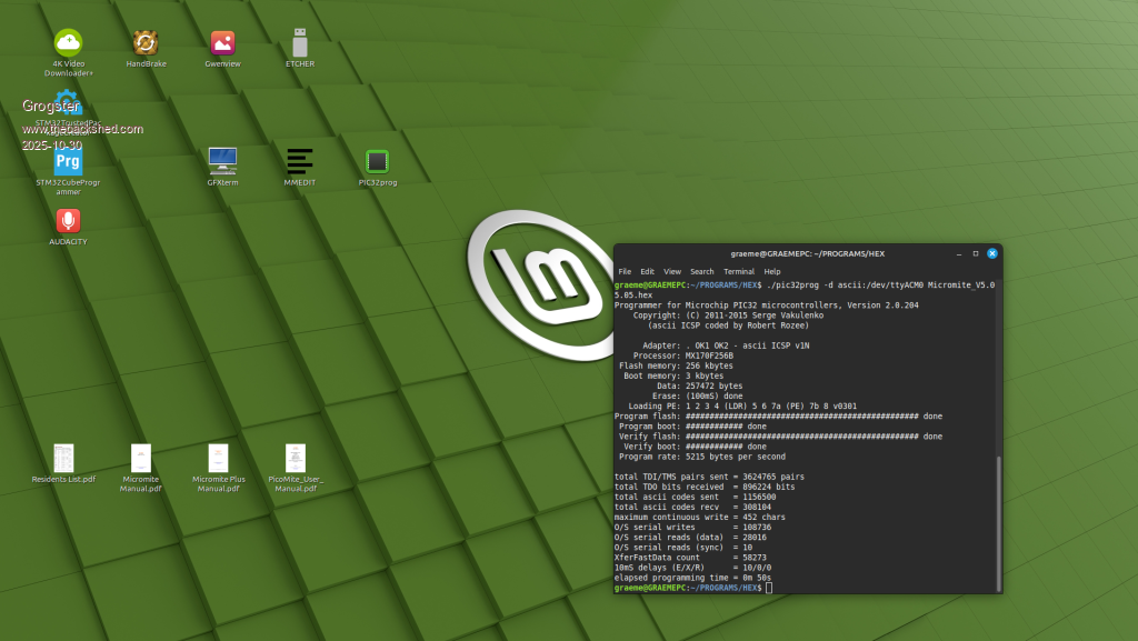

I guess this is a public question mainly for Rob, but is there a Linux version of PIC32prog + GUI for Linux?
If not, any plans to port it to Linux?
It's my go-to PIC32 chip programming tool, but I can't find a Linux version - probably cos there simply ISN'T one.
I COULD download and install the Linux version of Microchip IPE and use the PK3 units I have here, but I have always found that PIC32prog is better for programming chips, as it is just so easy and simple to use - you don't need to download a 600MB IDE to get the Microchip IPE part to program chips.  I have also found in the past, that it is much easier to get PIC32prog and GUI to work, then it is sometimes to get the Microchip IPE+PK3 to behave together.  Historically, I have had issues with IPE+PK3, whereas PIC32prog + GUI just works right out of the box.
...but I digress.
For now, I am simply using an old Win8 laptop with PIC32prog+GUI on it, to program the MMBASIC firmware into the virgin chips, after which, I use GFXterm in Linux to everything else from there, but it would be fab if I could also program the chips from inside Linux.

the Linux 64-bit version of pic32prog (2.0.204) can be downloaded from Serge's github repository here:
https://github.com/sergev/pic32prog/tree/master/linux64
while the Linux 32-bit version (2.0.203) is located here:
https://github.com/sergev/pic32prog/tree/master/linux32
i've just checked and can confirm that both locations contain working binaries. in the past i've just run the Linux version from a terminal/command window. the syntax is the same as the Win32 version:
user@HP-stream11-392758:~/Downloads$ ./pic32prog -d ascii:/dev/ttyACM0
Programmer for Microchip PIC32 microcontrollers, Version 2.0.204
   Copyright: (C) 2011-2015 Serge Vakulenko
      (ascii ICSP coded by Robert Rozee)
     Adapter: ................... OK1 OK2 - ascii ICSP v1N
   Processor: MX170F256B (id 26610053)
Flash memory: 256 kbytes
 Boot memory: 3 kbytes
Configuration:
[etc]
append filename.hex to end to program device, eg:
$ ./pic32prog -d ascii:/dev/ttyACM0 mmbasic.hex
i never bothered porting the GUI i created to Linux, but will try to have a look at creating a new version using Lazarus/FPC over the weekend.
rob   :-)

Thanks chums.
As there is a Linux version of PIC32prog that I was not aware of, I will download that, and simply keep it in the same folder as all the HEX files, so that programming via the terminal should be easy-peasy.  I'll try it out in the next few days.
Been on Linux Mint now 24/7 for almost two full weeks.  EASILY as good as W10, and having nothing other then minor little hiccups with things such as this.  Email/Internet etc, has been running flawlessly.
Posts: 10074
Posted: 04:37am 30 Oct 2025
Worked a treat:
Easy-peasey.
