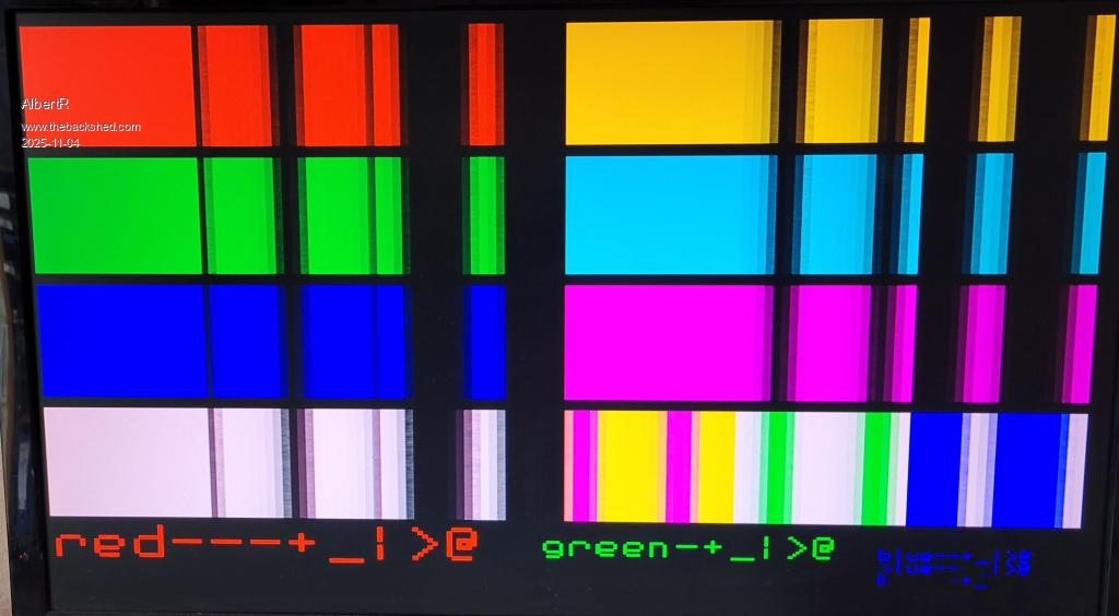

Hallo Peter,
very nice. Your program inspired me to change a few things about my PIOs. Thank you for that.
I don't know anything about VGA, but since the color signals are analog, some kind of “PWM” should work to reduce the number of RGB-pins.
I changed the output part of PIO 1
Pull side 1 'get the next data - don't block
Out pins,6 side 1 [9]
Out pins,6 side 1 [7]
Out null,2
to
Out pins,3 side 1 [2]
Out pins,3 side 1 [6]
Out pins,3 side 1 [4]
Out null,2
and add a function to arrange the colors
Function RGB222(R%,B%,G%) As integer
Local res%                                 '-1 because bit1 already shifted
  res% =        ((R% And 1)<<0)+((R% And 2)<<2)
  res% = res% Or((G% And 1)<<1)+((G% And 2)<<3)
  res% = res% Or((B% And 1)<<2)+((B% And 2)<<4)
  RGB222 = res%
End Function
The output is shown here. If both bits of an color are set it is ok, but it not I got a kind of of floating in the printposition. It looks like a diff of 5 pixel, that means one "pull". Could there be a lack of synchronization here?
output of:
mycls rgb222(0,0,0) '&H03
rectangle   1, 10,100,100,rgb222(3,0,0)
rectangle 101, 10,200,100,rgb222(2,0,0)
rectangle 201, 10,300,100,rgb222(1,0,0)
rectangle   1,110,100,200,rgb222(0,3,0)
rectangle 101,110,200,200,rgb222(0,2,0)
rectangle 201,110,300,200,rgb222(0,1,0)
rectangle   1,210,100,300,rgb222(0,0,3)
rectangle 101,210,200,300,rgb222(0,0,2)
rectangle 201,210,300,300,rgb222(0,0,1)
rectangle   1,310,100,400,rgb222(3,3,3)
rectangle 101,310,200,400,rgb222(2,2,2)
rectangle 201,310,300,400,rgb222(1,1,1)
rectangle 315, 10,414,100,rgb222(3,3,0)
rectangle 415, 10,514,100,rgb222(2,2,0)
rectangle 515, 10,614,100,rgb222(1,1,0)
rectangle 315,110,414,200,rgb222(0,3,3)
rectangle 415,110,514,200,rgb222(0,2,2)
rectangle 515,110,614,200,rgb222(0,1,1)
rectangle 315,210,414,300,rgb222(3,0,3)
rectangle 415,210,514,300,rgb222(2,0,2)
rectangle 515,210,614,300,rgb222(1,0,1)
rectangle 315,310,414,400,rgb222(3,2,1)
rectangle 415,310,514,400,rgb222(2,3,2)
rectangle 515,310,614,400,rgb222(1,1,3)
rectangle 5,614,7,634,rgb222(3,0,0)
printstring "red---+_|>@",  1,405,3,RGB222(3,0,0),-1
printstring "green-+_|>@",300,410,2,RGB222(0,3,0),-1
printstring "blue--+_|>@",500,420,1,RGB222(0,0,3),-1
printstring "blue--+_|>@",500,430,1,RGB222(0,0,2),-1
printstring "blue--+_|>@",500,440,1,RGB222(0,0,1),-1

Hi Albert,
That does not work.
Each time you do an OUT pins,... The base GPIO pin is the starting position.
So a OUT pins 6,xx sends data to GPIO 18,19,20,21,22,23
If you do an OUT pins 3,xx you send to GPIO 18,19,20
The second OUT pins 3,xx you send again to GPIO 18,19,20
So you never update pins GPIO 21,22,23

Hi Volhout,
that was my intention. I want to reduce the needed pins.
The idea is that the PIO mudulate the output.
Out pins,3 side 1 [2]  represent bit0 of the color, delay 3 tics
Out pins,3 side 1 [6]  represent bit1 of the color, delay 7 tics
color:
&h00 ->  0 tics high, 10 tics low
&h01 ->  3 tics high, 7 tics low
&h10 ->  7 tics high, 3 tics low
&h11 -> 10 tics high, 0 tics low
for that I rearrange the color to 00RGBrgb.
Thats the idea !

@Albert,
On a CRT that might work. Although the trace written will have traveled a bit between the 2 OUT's, in essence you are creating a 1280x480 (not exactly, it is only 1280 when you have the times identical).
But for LCD this will most likely not work. That LCD has an ADC that samples the video. There are 2 options:
1/ The ADC detects 1280 since there are more transitions than 640. But it can not do 1280x480 since that is not a known format, so t will not sync.
2/ The ADC samples in the middle of the "pixel". Since the time in MSB is longer, it will sample MSB only, and it will not see MSB of the color.

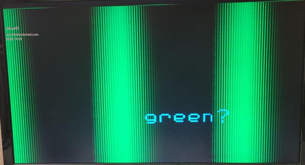

@Volhout,
that makes sense. The ADC only samples at his samplepoint. There doesn't seem to be any filtering in the tft.
My test results:
to 1. the ADC detects only the 640x480(info in tft-menue)
to 2. the samplepoint is not exact in the middle of the pixel, it moves, see picture.
The background has the color RGB222(0,1,0)
Finally it was only an idea.
