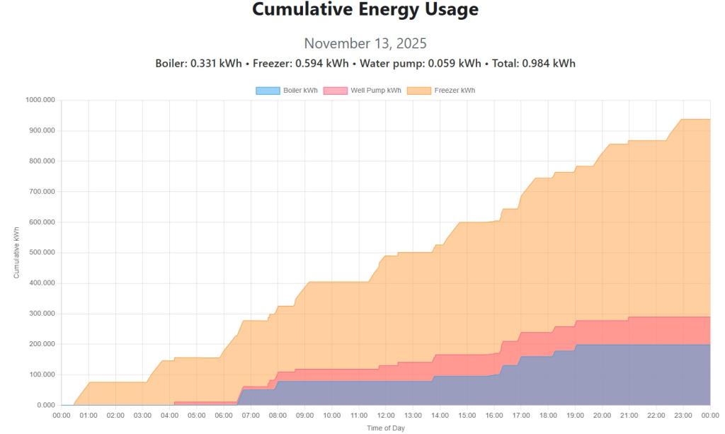

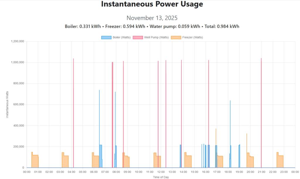

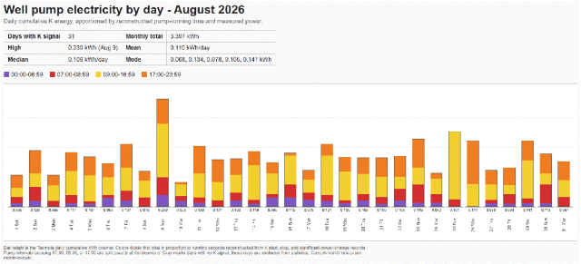

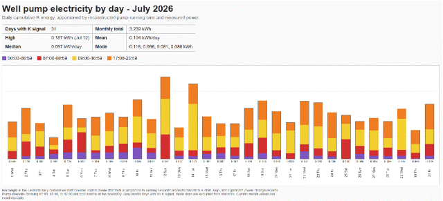

In preparation for (next year), trying to get my boiler, well pump, and freezer to run from solar panels, I had Gemini produce plots of daily runtimes.
Ok, total daily usage under a kilowatt (no real heating done with the boiler), so that's handle-able. Maximum inrush with the well pump just over a kilowatt, so that's ok. Inrush current for boiler and freezer only caught occasionally--around 700 watts for the boiler and 400 for the freezer. It might well be that they would never all three be drawing their maximum during the same few milliseconds, but most inverters will handle double their nominal rating for short periods, so that should be ok. I think a 1500W or 2kW continuous should be adequate.
Here's the cumulative daily usage.

I'm looking at the freezer inrush and to me that looks a little low and not captured sometimes, what device was used to capture inrush current?
I have several fridge's and freezers the older freezer runs at 100w but start surge on it and others will almost kill a 2kw generator, your inverter power requirement sounds about right if every thing is true and nothing is changed or upgraded.
And yes there is a time when all these loads can start at the same time (done it) if the power to the house has been off for some time 30 minuets on an hour and the power comes back on or reconnected  using the inverter most if not everything starts at the same time.
You could go for 4Kw inverter to cover that and have a lot of head room spare, also check Inverter idle consumption.
Cheers Aaron
Off The Grid
Posts: 3875
Posted: 12:25am 16 Nov 2025
  Revlac said  You could go for 4Kw inverter to cover that and have a lot of head room spare, also check Inverter idle consumption.
I think you're right there about a 4kW inverter. Whether or not the inrush current is caught is entirely circumstantial--every three seconds I poll the Tasmotized Sonoff  POW R3 16 Power Meter to retrieve instantaneous current. The spikes for the freezer at about 5pm and 8pm are catching at least part of that inrush current. Most of the time, it isn't caught.
I will have to check idle current. I may need to put a "slow start" intermediary on the well pump. Personally, for a couple of dollars worth of hardware, I think every major appliance should have slow start built in--pumps, fridges, freezers, ovens, microwaves, electric kettles, table saws, band saws, etc.
