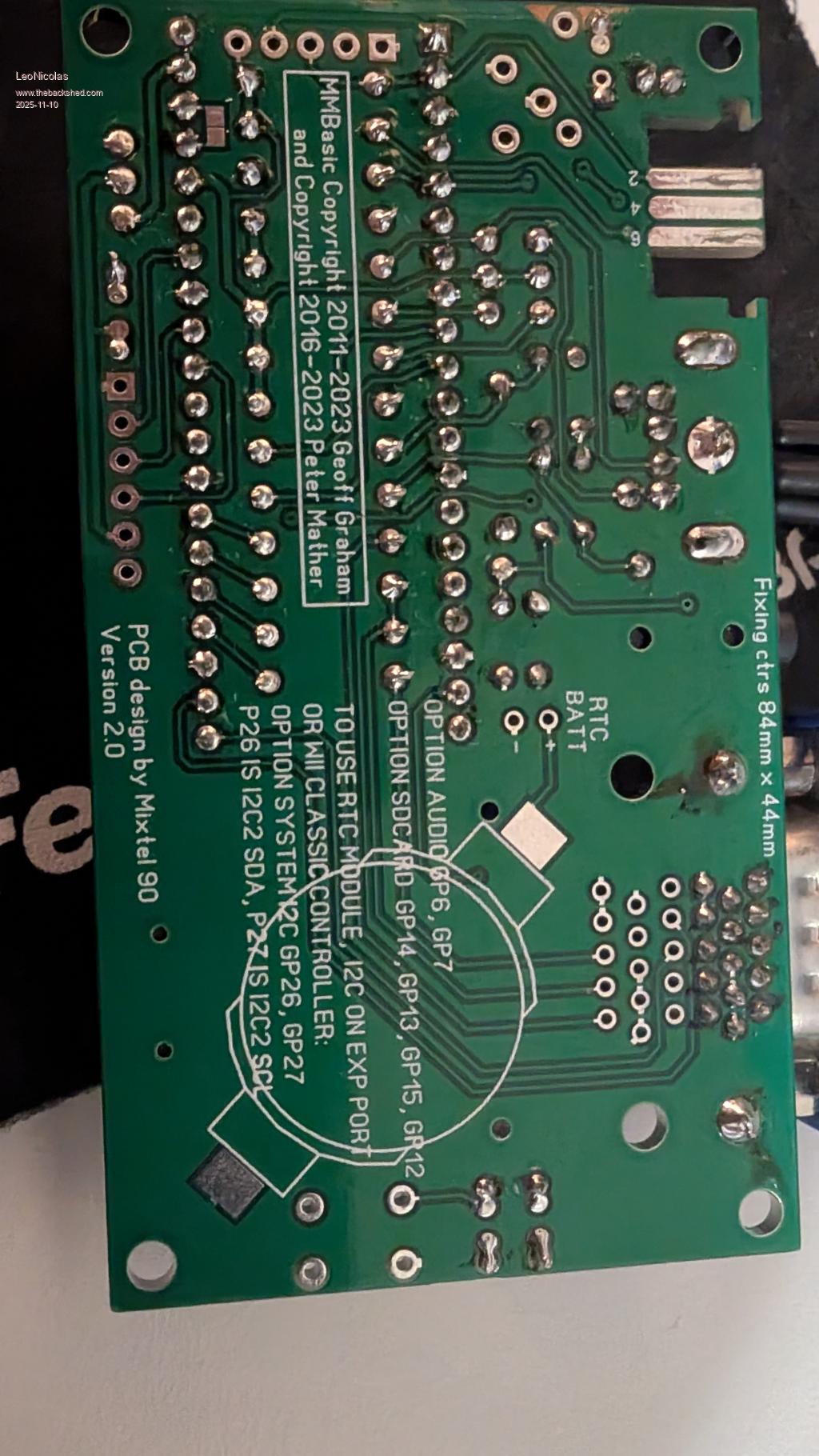

Hello
I have updated my PicoMiteVGA to the 6.00.03 firmeware (PicoMiteRP2040VGAV6.00.03.uf2). After the update I can't access the SDCard anymore. When I try to change to B:, it shows the following message:
Error: B: drive not enabled
The SDCard was working fine before the update.
Does anyone have an idea what could be the issue?

Posts: 6197
Posted: 06:34am 10 Nov 2025
Type OPTION LIST
Is there an option sd card ?
Check if the option settings are the same as in the document that came with the unit. Maybe your current setting are mismatch of pins.

LeoNicolas
Joined: 07/10/2020
Posts: 625
Posted: 06:58am 10 Nov 2025
Never mind, it is written on the back of the board
Posts: 9238
Posted: 03:38pm 10 Nov 2025
I recognize that board from somewhere... :)

Posted: 04:10pm 10 Nov 2025
  Mixtel90 said  I recognize that board from somewhere... :)
Thank you very much for writing the command at the back of the board. It was super useful.
