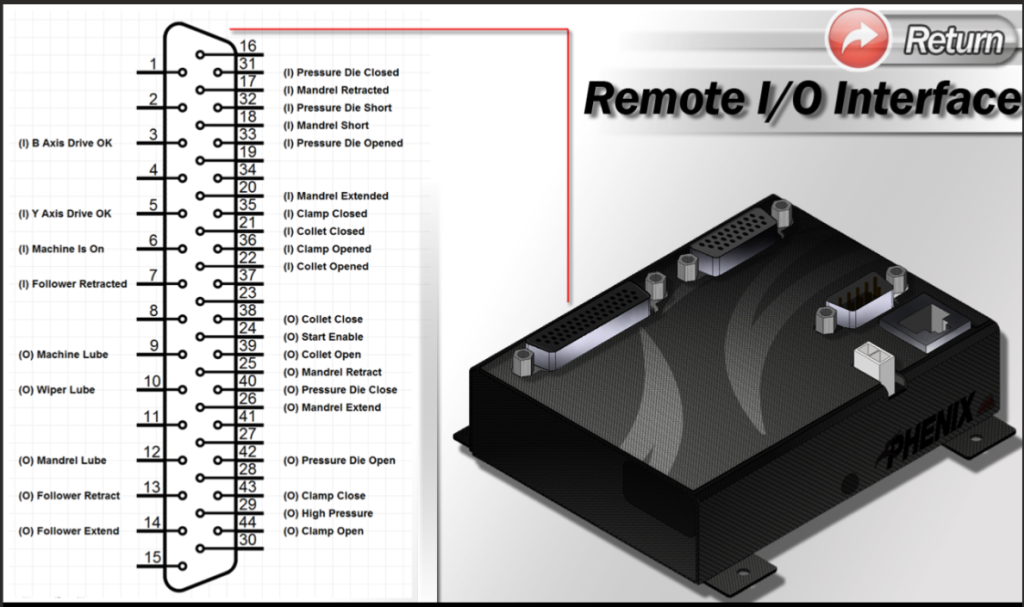

Another pet peeve of mine. I received a call about a machine that I was only vaguely familiar with and it had a Windows front end. "We are getting Error 0315, do you have any idea what this means?"
Are you kidding me...A full-blown computer that only provides error numbers that you need to look-up in the user manual (that can never be found)
Imagine a simple embedded application that only requires a PicoMite HDMI/USB.
The maintenance tech being able to connect a monitor, keyboard, mouse and getting a full description of the machine fault, suggested troubleshooting procedure, schematics, spare parts list, including sources.
And informative images such as:
No messing around finding that old XP laptop with the valid programming license and that proprietary RS485 cable with the obscure connector to interrogate some obsolete controller.
Possibilities are endless
