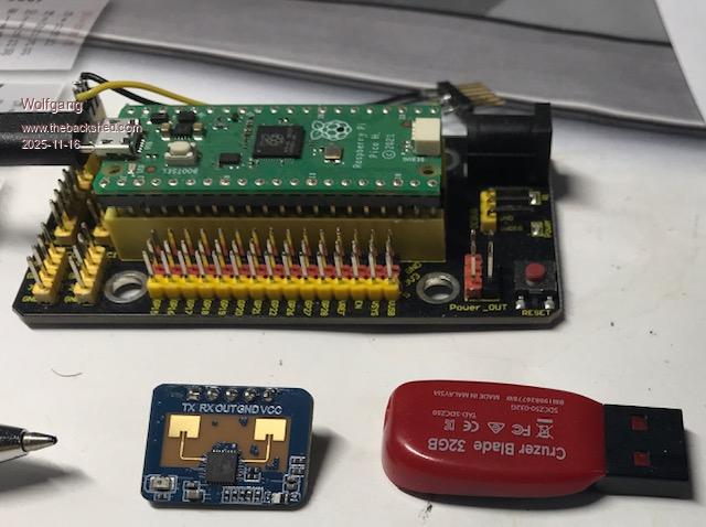

Posted: 10:07am 16 Nov 2025
@ville56
Thank you very much for this Pico programme. It is very impressive for me and thank you for your efforts in creating it. I can take a lot from it. The comments will help me to put the LD2450 into operation.
I have this version:
ville56
Joined: 08/06/2022
Location: Austria
Posts: 646
Posted: 12:02pm 16 Nov 2025
Wolfgang,
the radar on the photo is not a RD-03D or an requivalent  like my device as mentioned in the thread. So this uses a different protocol. Have to look it up, but the principle should be the same. Have you more Information about the type of your radar so I can make modification to the code accordingly?
73 de OE1HGA, Gerald

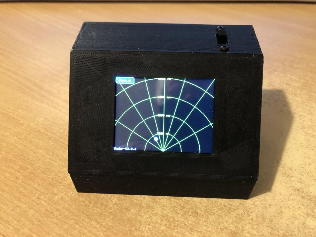

I just ordered both the LD2410C and the LD2450 from AliExpress. I'd like to contribute to the project with my RP2040. Perhaps it would be possible to display the object graphically on an ILI9341 display.
Best wishes! Joachim
ville56
Joined: 08/06/2022
Location: Austria
Posts: 646
Posted: 06:14pm 18 Nov 2025
Its running here with LD2450 on an ILI9488 display for one target. Should do on any LCD-display, even HDMI or VGA. The update rate is limited by the rate the sensor delivers data and this is 10/second and seems to be fixed. Could easily be extendend to track up to 3 objects. I have implemented the basic routines to deal with the sensor (sending commands and receiving ack and data messages) and the full control should be easy to implement, depending on what you want to do.
