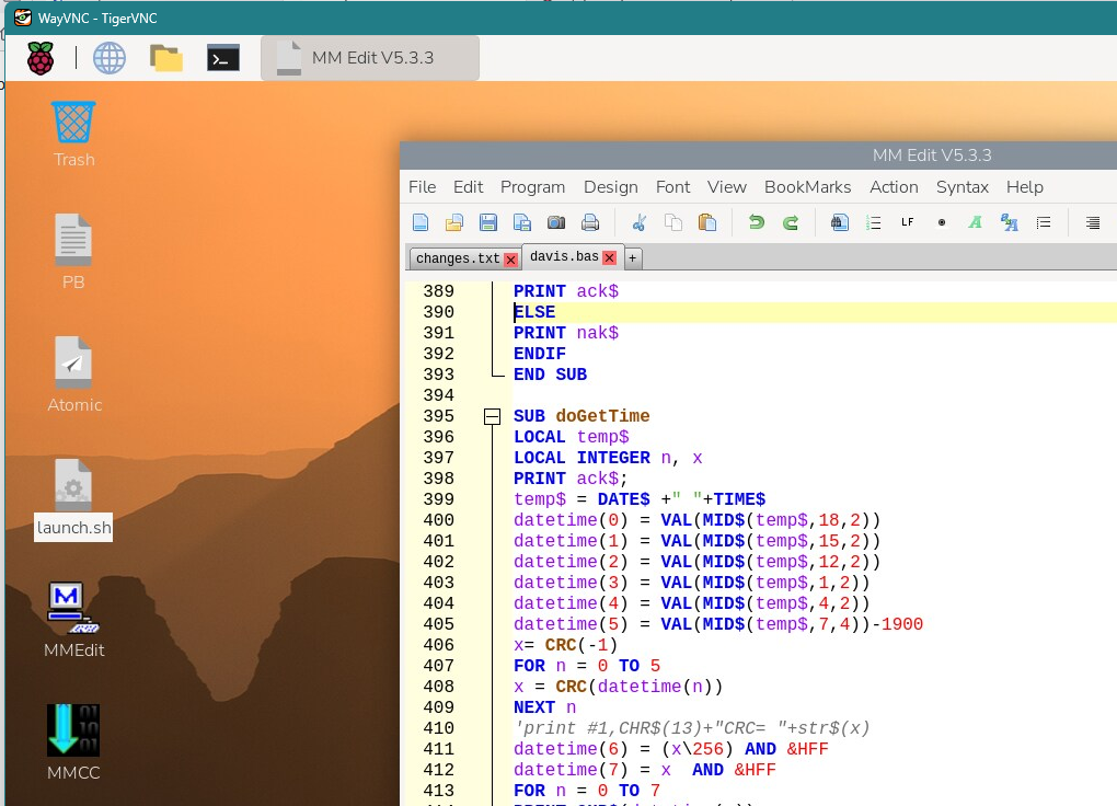

The usual recommendation is to do a clean install and then reinstall your applications.
I decided to try an in-place upgrade.
I do have a working bookworm safely stored away "just in case"
I followed the instructions here:
https://forums.raspberrypi.com/viewtopic.php?t=392376
I don't use a monitor on my RPi's and my usual tigerVNC from the main PC was used.
The only programs of interest in the experiment were MMEdit and PureBasic which I use  to compile MMEdit.
Everything still works!
Next I will try compiling a new version of MMEdit on the trixie image and check that it still works.
If successful and anyone is interested, I may offer MMEdit for RPi.
There are a few annoying "features" of Wayland but that's life.
Dear Jim,
I tested the current Linux/RPi build of MMEdit on Raspberry Pi 4 running Debian 13 (Trixie), ARM64.
set-rpi.sh completed successfully.
Unfortunately MMEdit won't start because it requires
libwebkit2gtk-4.0.so.37
which is no longer available in Trixie. Trixie only provides libwebkit2gtk-4.1-0.
ldd MMEdit reports this as the only missing dependency:
libwebkit2gtk-4.0.so.37 => not found
Everything else resolves correctly.
Is there a newer MMEdit (Trixie) build available?
Greetings,
Martin

deMaddin
Joined: 16/07/2026
Posts: 5
Posted: 08:38pm 19 Jul 2026
Hi dddns,
thanks for your reply, I succeeded so far, MMedit seems to work.
But I've problems with MCC, it doesn't accept <Return> and <Ctrl>-<C> and hangs quiet often.
Any ideas ?
