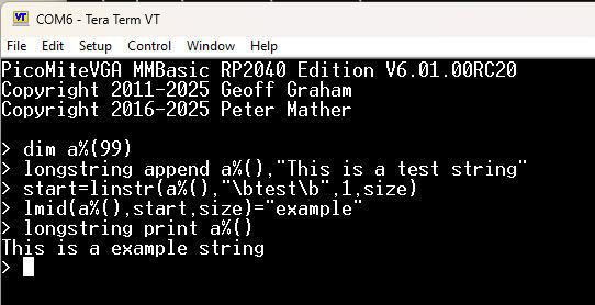

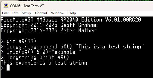

Posts: 12059
Posted: 09:02am 21 Nov 2025
Attached re-worked C code and header for a comprehensive regular expression support for MMBasic. Support for this code will be in RC19 for the PicoMite when released. I'll leave it to Gerry to include in CMM2 and update the documentation.
re.zip
This includes pretty comprehensive support for groups other than Anchors inside groups. I've also added word boundary support \b and \B. Below is the test script for this functionality. For me on a RP2040 VGA version this passes all test 100%

Posts: 12059
Posted: 07:39pm 23 Nov 2025
  Quote  Thank you Peter for including this feature.
In RC20 I will also include an new command LMID this is the longstring equivalent of MID$. This will allow you to have a large text file in a longstring and with a combination of LINSTR and LMID be able to edit it in quite a powerful way.
