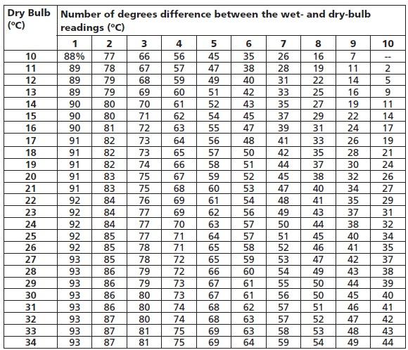

Can anyone point me to Psychrometric Tables, in table form not a graph, in Celcius. All I can find are tables in Fahrenheit. I asked AI and got all sorts of rubbish.
Posts: 3416
Posted: 02:42am 30 Nov 2025
Here is one I found . Only goes up to 40°C so you may have to extrapolate when it gets hot.

Posts: 6626
Posted: 02:50am 30 Nov 2025
This is one I found in '23
Using the formula I used back then, it would be easy enough to produce a table to cover your temperature range.
I will give it a go later when I have finished my 'real' jobs for the day.

Posts: 6626
Posted: 04:06am 30 Nov 2025
Had a break from the shovel
rh1.pdf
3 different formula giving slightly different results
Was 45 degrees high enough?

That's great Jim, it's just to test the readings I'm getting from Voltouts code. So far it looks good, been running all afternoon displayin RH at 1 minute intervals and seems accurate. Now to make up the hardware for the sensors, and the water to keep it topped up.
