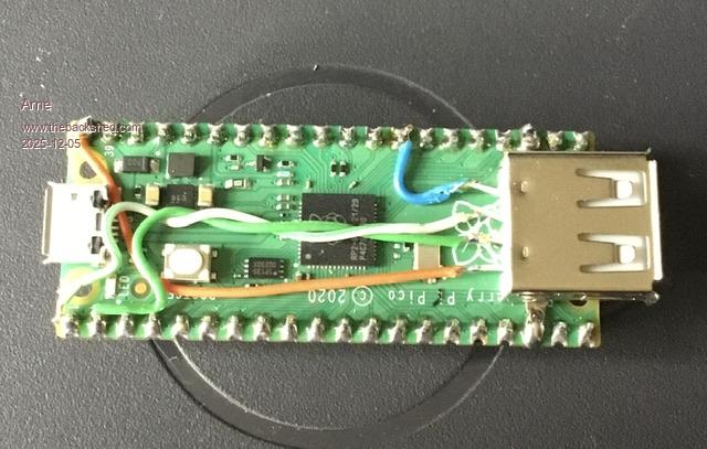

Within 5 minutes you can assemble an easy programable USB-device able to adapt functions of existing USB-devices to your needs or make your own USB - controller:
I first used it for the (blind) picomite configuration of the waveshare 2.8 zoll developer board (macros) where the serial link of the console could not be used .
Beneath all standard inputs of mouses,keyboards,controllers etc. also the GPIOs of the remapper can be used. Therefore with a picomite connected to the remapper-GPIOs special dynamic USB-devices as e.g IR controllers, voice controllers etc. can be built.
All details see here: https://github.com/jfedor2/hid-remapper
Have fun
