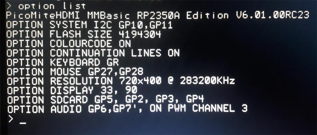

Amnesie
Joined: 30/06/2020
Posts: 763
Posted: 01:32pm 07 Dec 2025
Ah Sorry Peter, forget to mention that!
Here are some more infos:
Tested version with the problem: RC23
Settings, no PSRAM:

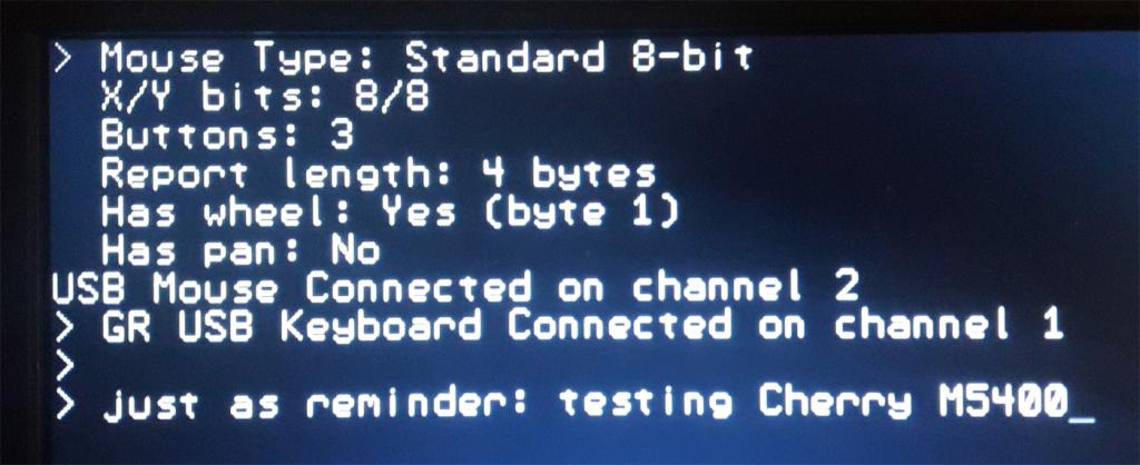

I have found another problem (bug?):
On the HDMI ps2 version, no problems with mouse, but on the HDMI usb version NONE of
my mices work. (all RP2350A)
Mices used:
- Asus GABKHBA58098 (usb only)
- Cherry M5400 (supports usb & ps2)
- Microsoft IntelliMouse (supports usb & ps2)
all of those mices work in the HDMI RP2350A usb edition of the firmware in the version RC11. So I think there must be either a change in the command or a bug.
If I connect all those mices it is recognized by the firmware, but the mouse does not
appear in all my programs and also not in the editor.
In short: None of my mices work in RC24, but in RC11 they do (HDMI usb-version)
IMPORTANT EDIT:
I tried it with:
OPTION MOUSE SENSITIVITY 1
then the firmware reboots and mouse works, switching back to SENSITIVITY 0
mouse doesn't work at all (don't even appear) - is this normal?
Greetings
Daniel
Edited 2025-12-08 04:45 by Amnesie
Posts: 12059
Posted: 07:47pm 07 Dec 2025
Sorry, silly typo when sensitivity is set to 0.
PicoMiteV6.01.00RC24.zip
If your mouse works properly with sensitivity set to something other than zero then use it as you will get wheel functionality
