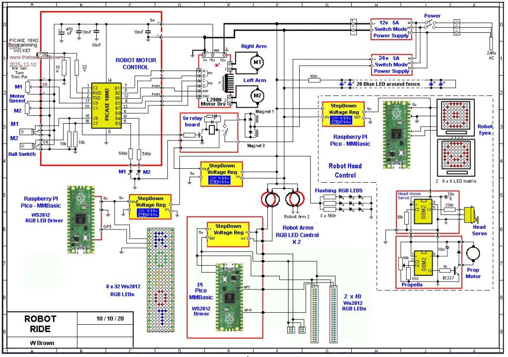

Hi Mick
  Quote  I am curious, are they mostly PIC based or are they now PICOs?
Generally  all the LEDs (WS2812 Strips)use a PICOMites.  The control of the motors in the carnival rides I use Picaxe 08M2 - 28x2s.  The matrix displays use PIC32 series chips.  Even the train has a picaxe 14m2 + Bluetooth control + DFPlayer MP3 for the sound and ultrasonic humidifier for the smoke.
Sample schematic of the robot ride.
Bill
