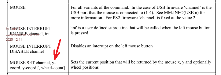

Posts: 6095
Posted: 08:20am 11 Dec 2025
Geoff,
In the function list, PIO(SHIFTCTRL ) shows 8 parameters. Missing are parameter 9 (joinrxfifoget) and 10 (jointxfifoput).
Please find attached PIO usage overview.
Peter, does the RP2350 PIO usage change between VGA121 and VGA222, or is it always using 2 PIO's ? Below table is "before VGA RGB222".
PIO_60003.zip
Edited 2025-12-11 18:26 by Volhout
