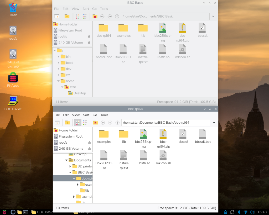

I tried to load BBC Basic on rpi 400 but the line chmod says file not found
Posts: 3813
Posted: 08:34pm 11 Dec 2025
You need to either fully qualify the path to the file you want to use chmod on, or switch to that directory.
Posts: 2807
Posted: 10:14pm 11 Dec 2025
I tried to the file home/stan/documents/BBC Basic, sane file not found . Linux is mew to me if on a a rpi it's debian so linux core. lots of fun
Posts: 3813
Posted: 10:28pm 11 Dec 2025
With a space between BBC and Basic, you probably need to put it in quotes.

on a terminal, run from inside the installation directory
chmod 755 bbcsdl
and try again ./bbcsdl
Posts: 3813
Posted: 12:45am 12 Dec 2025
  stanleyella said  I tried to the file home/stan/documents/BBC Basic
You also would need a slash before "home": chmod +x "/home/stan/documents/BBC Basic/bbcsdl".

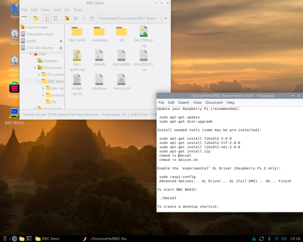

Posted: 02:04am 12 Dec 2025
Take note of the members when they talk about ./
Dot-slash is a Linux terminal command, that allows you to run an executable file directly from the folder that the file is in.  Without the dot-slash, Linux will try to find the file by searching through the locations specified in PATH.  As it is unlikely this program will be listed as a location in PATH, Linux says it can't find the file - even though when you look at the terminal screen......IT'S RIGHT THERE!!!
That one got me when I was new to Linux, but now dot-slash is one of my favourite Linux terminal commands.
The chmod command that is listed, should change the permissions of the BBC Basic file, to make it an executable(program) file, that Linux will attempt to run as a program.  Without being tagged as an executable file, Linux just treats it as another file on the system - but it won't try to run it.  chmod +x changes the properties of that file, so Linux knows it is supposed to attempt to run that file as a program.

Posts: 2807
Posted: 04:54pm 12 Dec 2025
do I use the bbc 64bit folder which I opened and copied the install 64bit into?

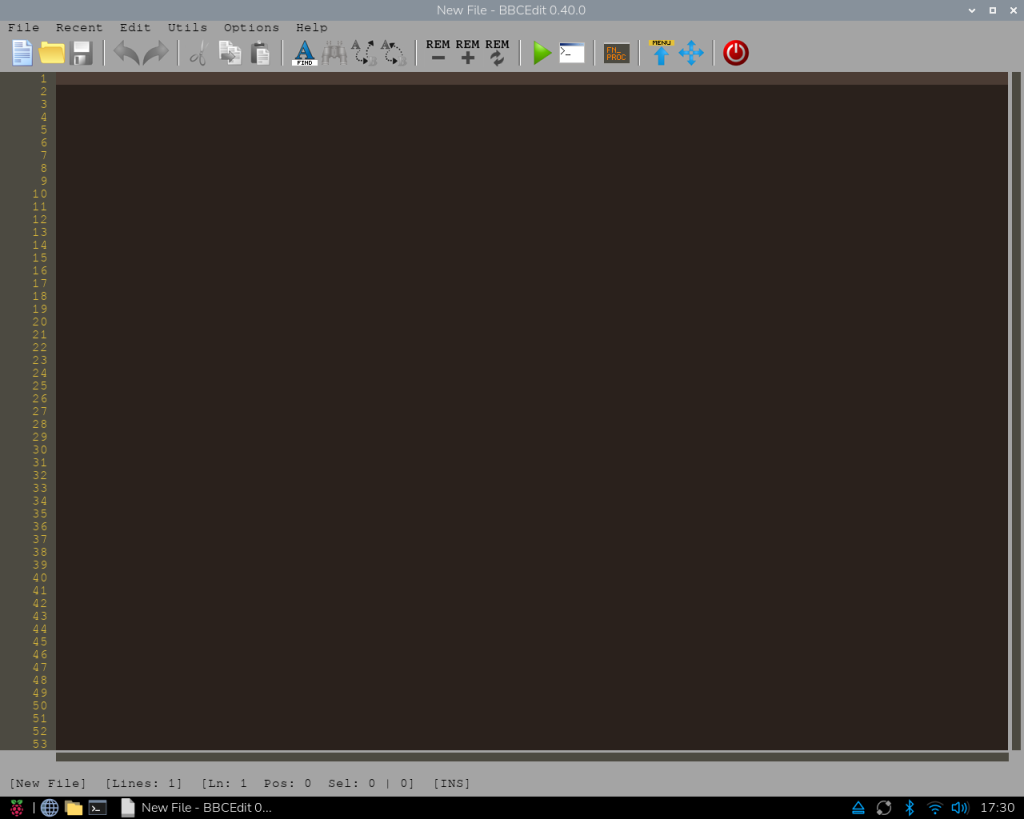

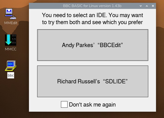

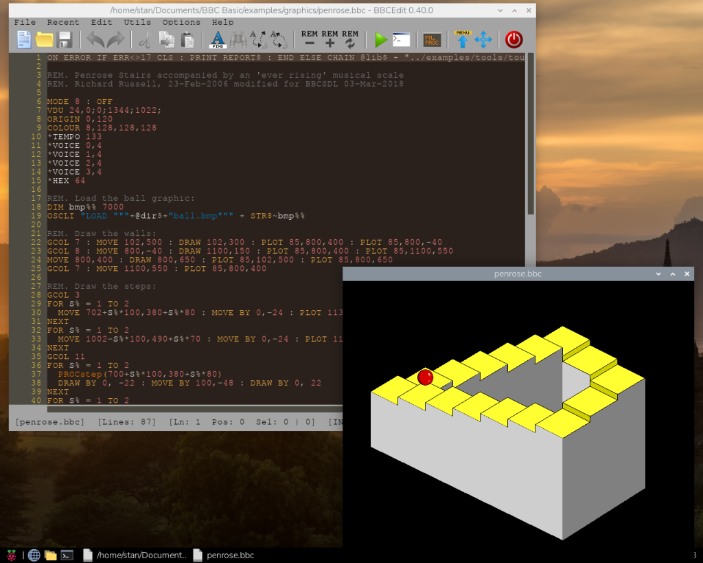

Posts: 2807
Posted: 05:32pm 12 Dec 2025
got this, what is it? The other ide is slide
Edited 2025-12-13 03:42 by stanleyella
Posts: 4352
Posted: 06:33pm 12 Dec 2025
Looks like an empty file, as it says, though it may have 1 blank line.
Posts: 2807
Posted: 07:16pm 12 Dec 2025
Sort of far out, groovy. It works. Thanks guys for help. stan

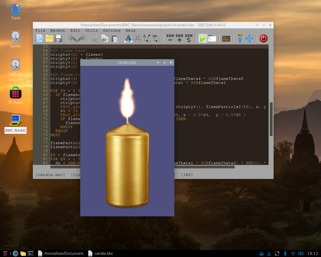

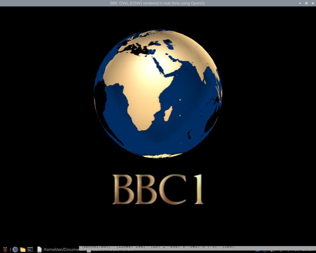

Posts: 2807
Posted: 08:21pm 12 Dec 2025
I like bbc basic from little experience on rpi 400. new toy.
edit, this rotates smooth, dunno how for bbc basic
