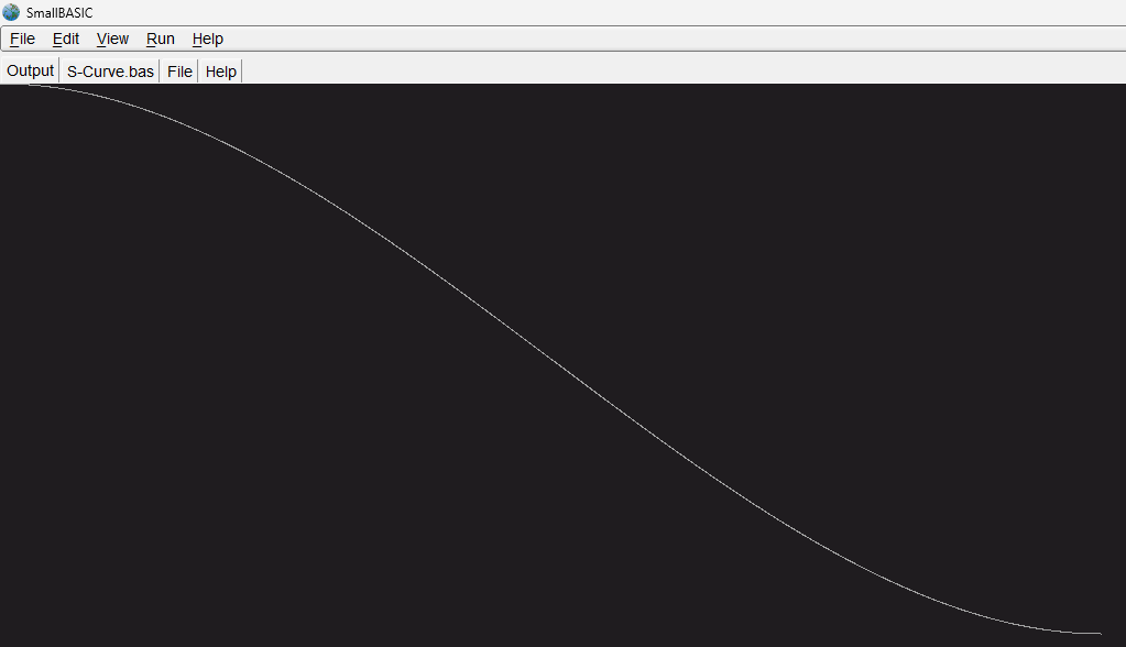

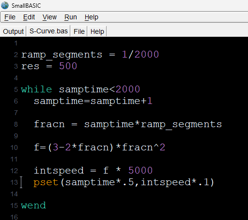

This is the most efficient s-curve that I have come across:
I have it in SmallBasic here:

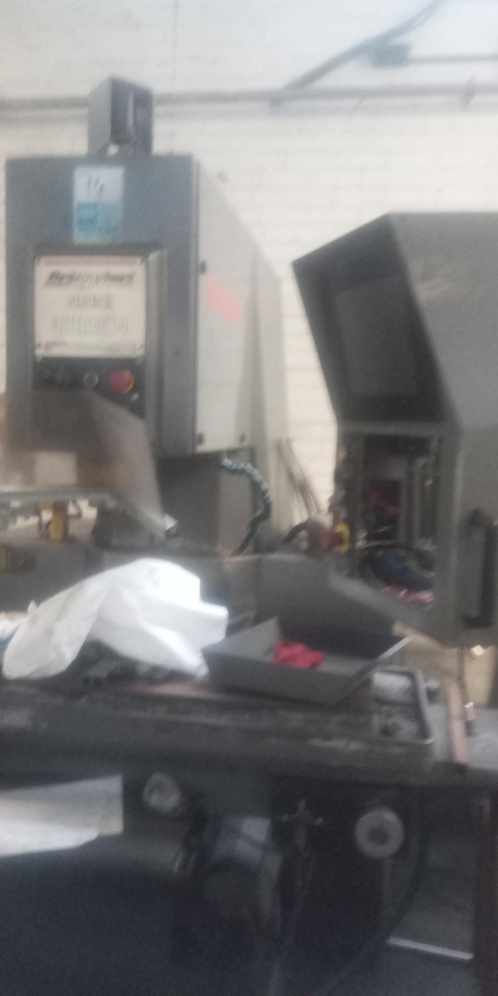

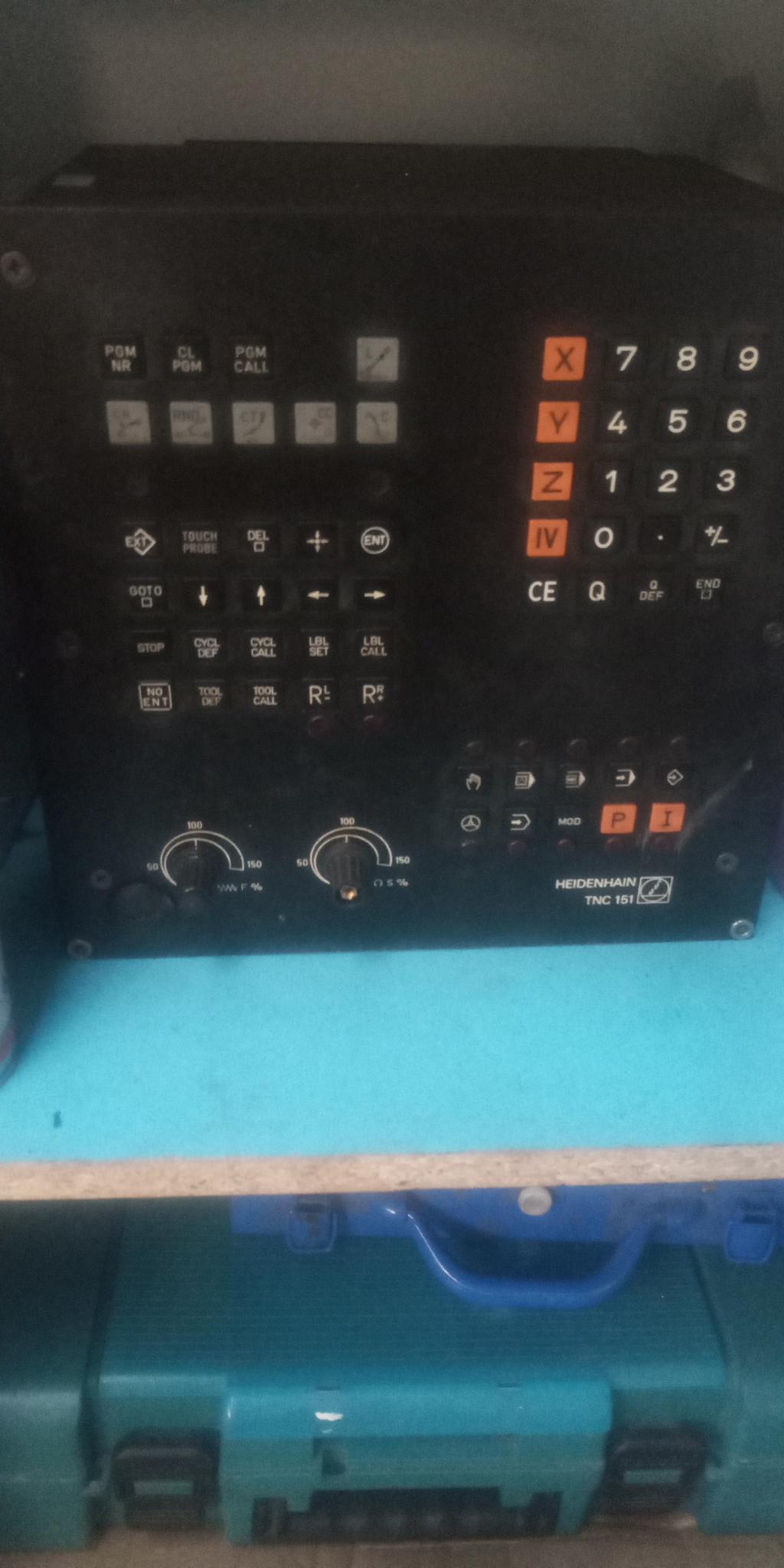

  dddns said  Two ideas: please take a look at the Heidenhain  dialect introduced with TNC151/155
And in any case, radius compensation is a very practical feature
I have two dead TNC151s on Bridgeports and a third that is on borrowed time.
This is getting too bizarre....How come things keep happening just-in-time for ME?
Edited 2025-12-18 22:19 by PhenixRising

We were just discussing; do we go G-Code or conversational? Well G-Code is a "gotta-have" but back in the nineties, I supplied lathe controls to Mupem in Bilbao.
At that time, they wanted to cater to "mom and pop" shops that didn't have CAD/CAM.
Conversational is really nice so I might end-up doing both
Our 1KHz PID-loop is four times faster than the TNC151's 250Hz   (Edit: TNC151 doesn't even have full PID)
This is too bizarre...It's a conspiracy, I tell ya! Someone is reading my mind
Edited 2025-12-18 22:30 by PhenixRising
