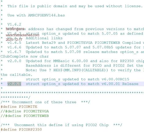

Hi Geoff,
thanks for your great work!
Can you confirm that the "PicoCFunctions.h" (V1.5,  #define BaseAddress   1000030C) in the C Routines folder is up to date and works with this MMBasic version? I'm asking because I have version v2.0.1, which seems more "modern" to me. I think CSUBs are being neglected and have been somewhat forgotten.
If there are any further updates to the manual, I would appreciate it if the size of the buffer required/expected by the Play MP3, WAV, and FLAC commands were also specified. For example, 30 KB heap is needed.

This is an up to date PicoCFunctions.h that covers both PICO and PICO2
v2.0.2  Calltable address now 0x1000023C for RP2350 v6.01.00 Release
PicoCFunctions.zip

Geoff. The PicoCFunctions.h above from Gerry (disco4now) should replace the one currently in the download
Edited 2025-12-17 23:06 by matherp
Posts: 3369
Posted: 03:01pm 17 Dec 2025
  matherp said  Geoff. The PicoCFunctions.h above from Gerry (disco4now) should replace the one currently in the download
OK.  The download has been updated.

I'm wondering if it would be useful to include the working command "MM.INFO(CALLTABLE)", which displays the BaseAddress, in the manual. Are there any reasons not to do so?
> ? hex$(MM.INFO(CALLTABLE))
1000023C
Kind regards

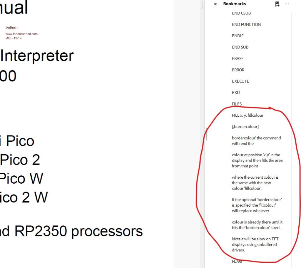

Geoff,
It may be just me, but I find the command list (in several places) is corrupted. Maybe you could confirm this is also shown at your original ? See below picture. This is the user manual that I just downloaded (19/12/25 13:00 CET).

Seems OK to me, though file shows as
Dec 18 20:54 PicoMite_User_Manual.pdf
GMT here.
Edited 2025-12-19 22:46 by JohnS

Posted: 02:20pm 19 Dec 2025
Command list also corrupted in my user manual. Dated/downloaded 16.12.2025.
