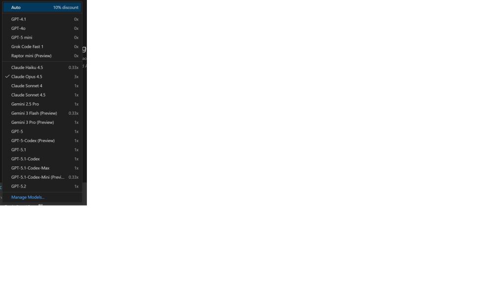

Posts: 12058
Posted: 08:43am 09 Jan 2026
Excellent work
  Quote  I made some progress yesterday with Gemini, but it was often frustrating.
  Quote  but this morning I subscribed to Claude Pro.
I use AI through the Github Copilot Chat plugin to VSCODE. This give me access to a range of models for a single monthly fee. For simple stuff, I use Claude Sonnet or GPT-5.1-Codex-Max. But for the hard stuff Clause Opus 4.5 is miles ahead of the others but consumes budget much faster with a x3 budget ratio.
Edited 2026-01-09 18:43 by matherp

Posts: 12058
Posted: 02:11pm 09 Jan 2026
  Quote   Claude informed me (at about 6:30pm) that I had run through my budget, and the next refill wouldn't occur until 8pm
