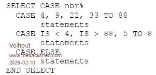

Posts: 6196
Posted: 11:19am 10 Feb 2026
Alternatively use SELECT CASE
Similar to this (from the manual)
