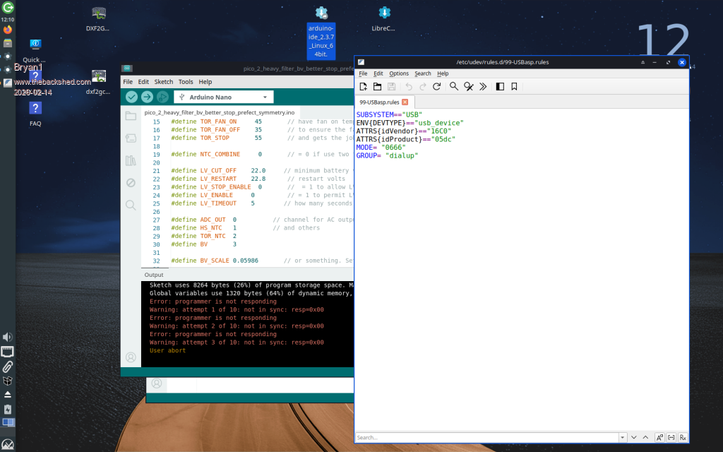

Bryan1
Joined: 22/02/2006
Posts: 2297
Posted: 01:46am 14 Feb 2026
Ok made up that 99-USBasp.rules file and added in all those rules which were the same as the ones I got off the google AI when I researched the USBasp on linux.
Thats after I did a reboot too so more fun to be had.....

Can you copy this exactly in one line and insert it in the file:
The stuff you showed has errors.
SUBSYSTEM=="usb", ENV{DEVTYPE}=="usb_device", ATTRS{idVendor}=="16c0", ATTRS{idProduct}=="05dc", MODE="0666", GROUP="dialout"
Posts: 3416
Posted: 02:27am 14 Feb 2026
Bryan, you have GROUP="dialup" instead of GROUP="dialout".
Copy'n'paste from KeepIS's post should eliminate typos.
