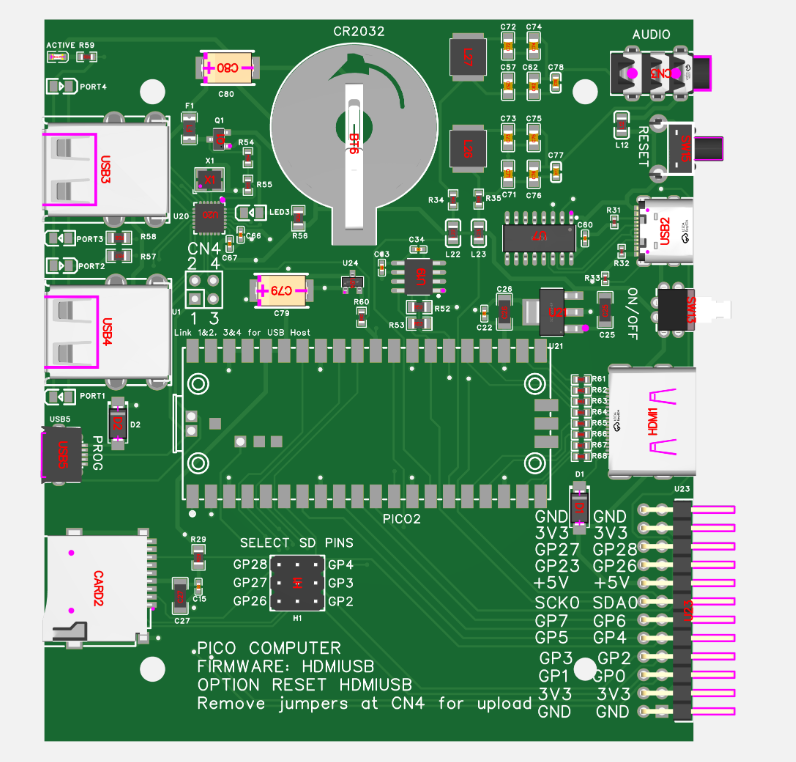

wondering why not made the spot where pico2 goes no holes

those ports1 to port4 are those needid ? just leds ?

The Pico2 is intended to be soldered directly to the PCB.
The reason is the USB pads are on the underside of the Pico module. On the PCB the pads that align with them have holes so you can feed solder in to make the join.
There should be complete instructions In the "Other Downloads" section here https://geoffg.net/picomitevga.html

can also use pico 2 w on the pcb
Posts: 3416
Posted: 06:48am 20 Feb 2026
No, the WiFi code takes enormous resources.
Simply not enough left for HDMI or VGA.
