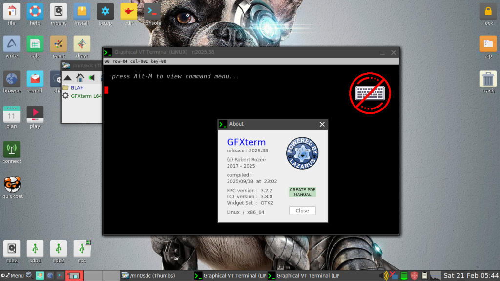

Thanks for the posts, chums.
It worked the very first time I tried to run the GFXterm file in Puppy.
No error messages, no need to run in the terminal, it just popped up as expected.
I'm using an old-ish Bionic64(v8.0) Puppy image using Linux Kernel 4.19 circa February 2019.
This is a small-ish ~300MB ISO, which is plenty small enough for my simple serial terminal and logging purposes.
I do note that the latest Puppy build(Trixie) is up to 1GB in size, which is starting to get away from the concept of Puppy being a lean and SMALL Linux install.
I downloaded Trixie anyway, and plan to boot that up, just to play about inside it, and see what has changed.
But for running a logging terminal(GFXterm) in an isolated system(NOT connected to the internet), Puppy seems to be ideal.
The tinkering continues, but so far, so good.
