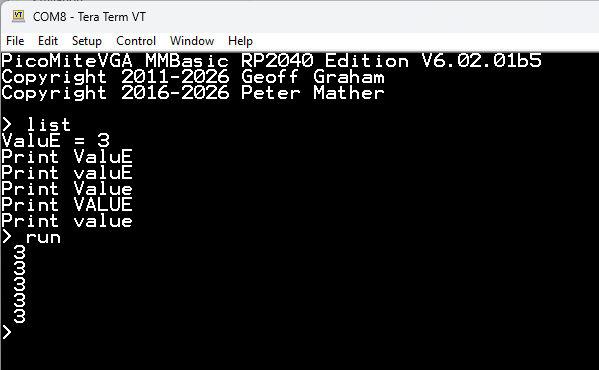

I am using MM Basic  user manual version Ver 5.07.04 which states that the interpreter is not CASE sensitive but I found otherwise recently.  I usually use capitals for all program names subroutines values etc and lower case for the rest. I downloaded a set of routines lately that had a mixture of cases that refused to run. I found after battling the error messages that a variable must be identical letter for letter to the definition.
For example if your variable  name is ValuE then none of the following are recognised as equal to ValuE. e.g valuE, Value, VALUE or value.
Has this always been the CaSe?

The only thing that is case sensitive is filenames on the A: drive which is a function of the LittleFS file system

Just tried mmb4l and it behaves as expected (case insensitive variables).

Thanks for the reply matherp and JohnS. That is exactly what I expected to happen. I was battling with this all yesterday when it refused accept anything but the defined variable spelling. I tried your example and it worked then I thought perhaps the  OPTION SPECIFIC at the head  of my program made it case sensitive. I disabled that and  it worked so I replaced OPTION SPECIFIC and it continued to work!!! I give up as long as it works.

Thanks everyone. You are right it should have been OPTION EXPLICIT. The program in which I am going to use the I2C routines is already using that. I later tried removing EXPLICIT but that made no difference.
I have no idea what could have caused it to become case sensitive. It literally happened overnight. I was working all day the day before and closed down my computer as usual but the next morning I noticed it came on remarkably quickly. I wont say booted up because it looked like it hadn't switched off. Maybe something was updated overnight. (Windows 11) Anyway my I2C hardware is working nicely now.
