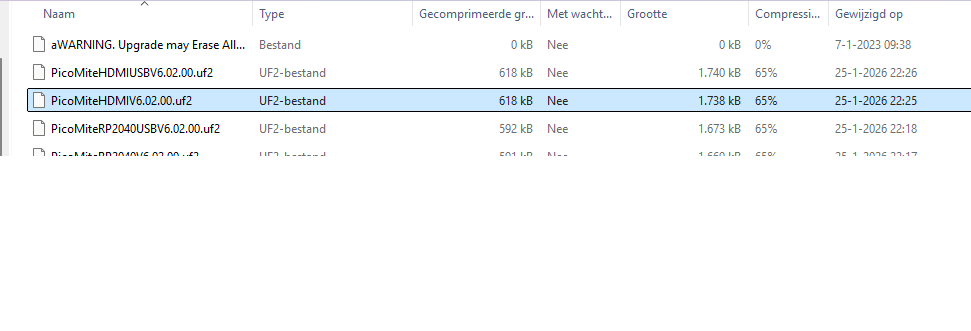

out of the box the hdmi works how do activate sound and the sd card
and need the correct firmware i try the newest firmware from the webpage then cant do

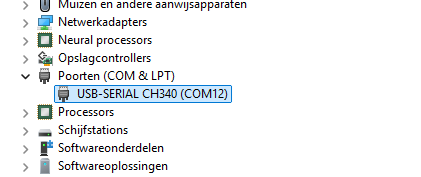

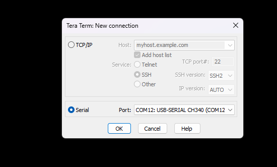

think fail so hard can only connect the board to micro usb then do firmware on the board no jumpers on board then if do the firmware pico hdmiusb on the board it is over
sofar do usb c cable in the board do the power switch a  COM port comes up i connect to it and it fails :( i give up on this picohdmi board maby i can donate my 4 unsoldert boards from jlcb then place all the parts on it missing leds that command says got wrong firmware whit this board so dont think ever gone work

now stuck here cant login to the board only what working if use the hdmi firmware whit out the usb

If you can't install the firmware, and the links at CN4 have been removed, then you are probably trying to install the wrong firmware. You are using a Pico 2 aren't you?
I hope I've got this right...  :)
Open File Manager so that you can see the list of MMBasic versions
Switch off the Pico board
Remove the CN4 links
Connect the USB-C on the Pico to the PC
Hold down BOOTSEL on the Pico and switch the Pico board on
Release BOOTSEL
You should see the virtual drive appear
Find the correct file and drag it onto the virtual drive.
(It will be called PicoMiteHDMIUSB - nothing else will work)
You should get a pop-up box while the file copies
After a few seconds the Heartbeat LED should start flashing
Unplug the USB lead from the Pico and move it to USB2
Replace the links on CN4 1-2 and 3-4
Connect a USB keyboard to one of the USB connectors
Switch on the Pico board
Start Tera Term and look for the new COM port. Connect to it at 115200 baud
You'll probably get a blank screen. Press Enter a couple of times and you should see the ">" prompt.
Enter OPTION RESET HDMIUSB
Try OPTION LIST and you should see things that make sense.
Now you can connect your HDMI display, where you should see the same thing as the console. You may want to change your keyboard language.
At this point the console isn't really being used so you can carry on working with the HDMI display.
I'm sorry if I've messed up any of the above, but It's been ages since I set mine up and my memory isn't what it once was. :)

try this firmware
Posts: 9238
Posted: 08:24pm 27 Feb 2026
You can't use the USB display until it's been set up by OPTION RESET HDMIUSB. You will be in the console until then. The console is on USB2, NOT the USB port on the Pico - that's in host mode as soon as MMBasic starts. It's also disconnected from the USB-A ports until you put the CN4 links back.
Use the HDMIUSB firmware and follow my instructions. Don't use the HDMI firmware as there is no default keyboard if you use that. The board is designed for a USB keyboard.
