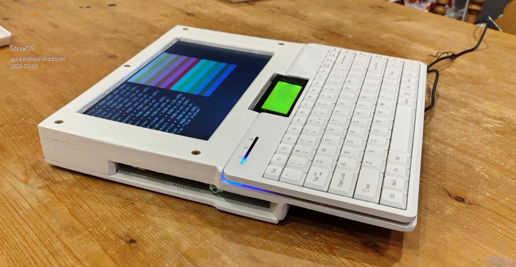

Afternoon all,
I got a bit fed up with working on a bunch of parts spread over the table, so I faffed about with some old MDF drawer-bottoms, a 10" car LCDTV, a Perixx PS2 keyboard and a Pi-Picobuddy board to make something a little more user-friendly.
I really wanted one of those Tandy TRS-80 Model 100's back in the day, and latterly got an Amstrad NC100 and a Sinclair Z88 to play with. The limitation was always the relatively small character display, and the slab format has its flaws, but I still like it for the nostalgic value and now I can pick everything up and carry it around a lot easier.
Dave

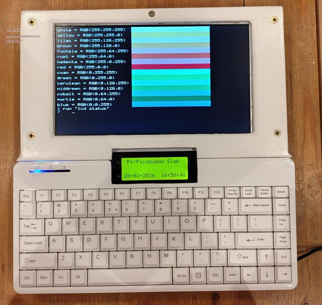

Is this HDMI and what resolution(s) are possible?

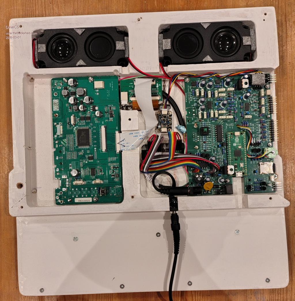

In the photo of the internals both the Pi-Picobuddy PCB and the monitor PCB have a VGA socket footprint but I don't see a HDMI one on the Pi-Picobuddy.

It's just VGA. I have it set to 800x600, which is the native resolution of the LCDTV screen.

The LCDTV came with HDMI, VGA, BNC etc. interfaces, and the Pi-PicoBudddy only has a VGA output. To keep everything as compact as possible I removed all the unecessary connectors and hard-wired the necessary pins of the two VGA socket footprints together using a short length of cable salvaged from an old VGA lead, keeping individual screens etc. as intact as possible.
The slightly trickier bit was bodging on a "Source Selection" button so that the screen defaults to the VGA input, since I wasn't using the front-panel board from the LCDTV. It remembers the last setting, thankfully, but I've left the pushbutton as a recessed-access control just in case it ever forgets.

I should add that it's using the Pi 2 to get 800 x 600

  mozzie said  G'day Dave,
That is a great looking unit    very nice work.
If you hadn't mentioned it is made of MDF I'd have assumed it was some flashy textured plastic material.
Lyle.
Cheers Lyle,
It wasn't great MDF either, the stuff used to make drawer bottoms, except for the thicker slab used to make the housing for the boards which came out of the offcuts bin at the local DIY store.
A couple of coats of Zinnser Bin primer/sealer and some 160 grit-enabled elbow grease worked wonders, though. The Z-B soaks well into the MDF and sets hard, so the surface feels like plastic.
Dave
