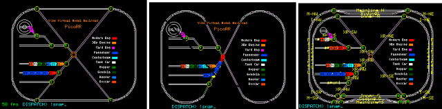

Vibe Virtual Model Railroading
I wanted an application to exercise and test PicoDB . About 8 weeks ago, someone mentioned an interest in model railroad control. After I finished PicoDB, I thought that might be just the ticket. I had an HO gauge layout when I was a teenager, but have hardly given a thought to it in 60 years.
I started work on it with Gemini on February 14. The exercise has been a success--the virtual model train works, and PicoDB serves it (and we found and fixed 4 obscure bugs in PicoDB).
The program, PicoRR.bas, is 2058 lines long. The PicoDB library is 2545 lines. That's 4600+ lines of MMBasic code from Gemini since January 13--50 days, 92 lines a day (but with 2 sets of guests visiting and a porch built on our shed which subtracted about 10 days total).
Here's a youtube video of 4 trains running. The frame rate is only 1-2 frames per second, but if this were translated to an 8-foot by 6-foot layout, the speeds would be pretty much in range: PicoRR Demo  (doesn't hurt to run it an 1.5 speed).
Here's the script which drove the video:

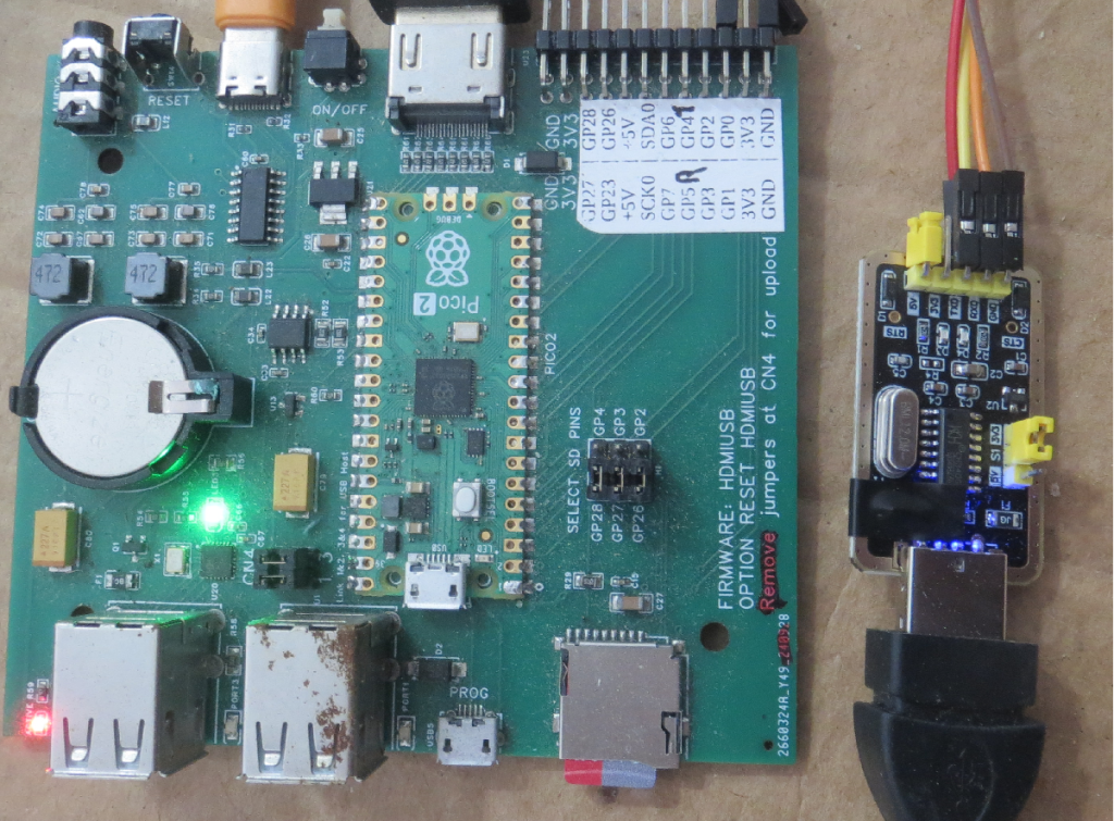

This is running on Peter's Pico2 HDMI PCB:
You drive the trains by typing commands (on PC/laptop keyboard--I don't have a keyboard attached to the PCB) at the "DISPATCH>" prompt on the Screen/LCD. For instance, s6+ve1 20 will flip switch 6 out of spur2 and start up the train behind Engine E1.
Here's the quick help ("?" at the "DISPATCH>" prompt) for dispatch commands at the keyboard.

There are 3 layouts available at present:
Fuller documentation is in the zip file, which contains everything needed to run on a Pico2 HDMI, 640x480 Mode 3. I think it will work with VGA, but haven't located the boards I know I have somewhere. I have it displaying, but not yet running, on LCD 320x240 and 480x320.

Last night I asked Gemini to start to implement sprites instead of drawing all those boxes (and then the tracks underneath them when the cars moved)--all as an option in addition to the existing features. Car and engine sprites were just to be circles, which made placement easy. The mode was to be set/reset with !sprites.
I thought this might take some time (days?), but in a few hours, it was to the point of just needing tweaks. Speed jumped from 1-2 frames per second (which was good enough) to 6-7fps with engines E1 and E2 moving with cars. This morning, all settled and here's the video:
PicoRR with sprites
This is the script its running:
!show c,!sprites
s6+s3+s15+s11+ve1 20
at e1 Mainline-W
s7+s6-ve2 15,sv+s1+s2+s4+
at e2 Inner-E
s15-s11-s7-

PicoRR works with Mick's GAP2V1 HDMI/DVI PCB for the WeAct RP2350B module with the Adafruit DVI Breakout module (There's now a GAP2V2 )
The PCBs from JLCPCB arrived yesterday afternoon. I soldered sockets and plugged in a working WeAct module. No joy and no voltage on the modules 3V3 pin. I PMed Mick and he said the layout was designed for the regulator, and the EN pin on the WeAct was tied to GND. I snipped off the EN pin, plugged it in, and it came alive.
I still had to supply 5V to the DVI module, so I ran a wire this morning. Voila, output to my HDMI monitor.
The Adafruit module will fit under the WeAct, but I put this one on the underside of the board. The only additional thing I want on this board is the RTC. I ran a wire, but it's not seen. I haven't traced that down yet.
I may also want to repurpose the CP2102 for an HC-06 bluetooth module.
