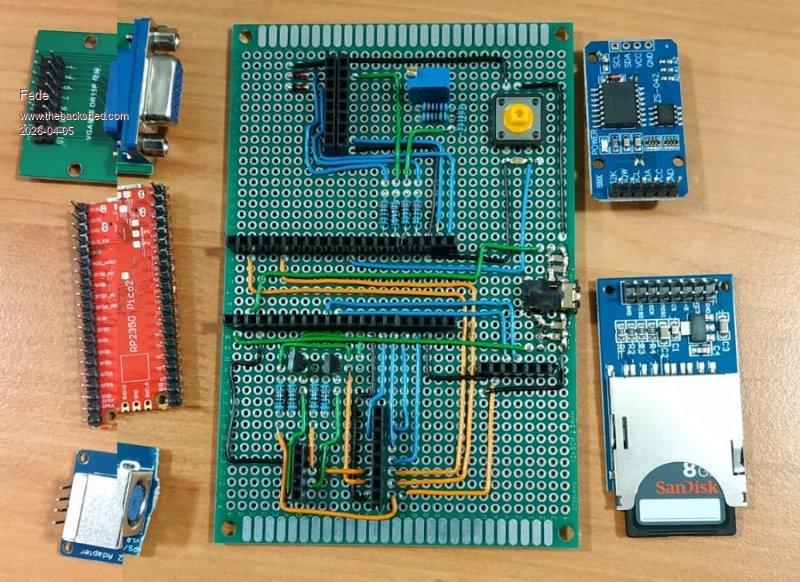

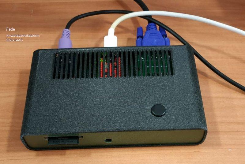

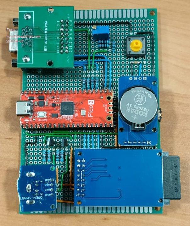

Fede
Joined: 09/03/2026
Location: Spain
Posts: 24
Posted: 06:00am 05 Apr 2026
Thanks. Thank you so much for the information.
I don't use PicoCalc much.
I program in the VGAPicoMite that I built myself and then check if it works in PicoCalc.
I find it more convenient that way.
And while we're at it, here are a few photos.
The bad thing is that my short vacation is about to end.
Peter63
Joined: 28/07/2017
Location: Sweden
Posts: 217
Posted: 06:22am 05 Apr 2026
  Quote  I program in the VGAPicoMite that I built myself and then check if it works in PicoCalc.
Ok, I also usually do something similar when I test things.
