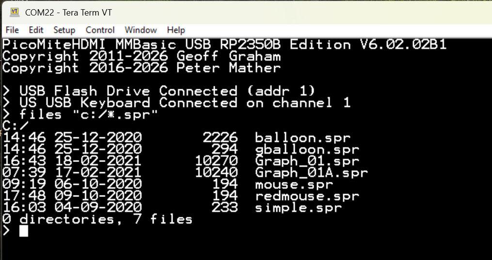

Full support for USB flash drives implemented as drive C:
HOWEVER
runs like a dead pig
It transpires that a combination of the rp2040/rp2350 USB hardware and TinyUSB limits reads and writes to one 64-byte packet every millisecond. i.e a maximum thoughput of 64Kbytes/second.
This means that although it could be used for loading and saving files etc. it is too slow for streaming any sort of audio and, as an example, a bmp file which takes 1.3 seconds to load from sdcard takes over 17 seconds to load from the USB disk.
What a waste of a day

You can't win 'em all. It's not that the singing dog sings badly, it's just amazing that it can sing at all. :)  Crikey, at one time 64Kbytes/s would have been considered fast. :)
Well done for trying anyway!

I don’t see it that way! I think it’s great that it works. Will it still be in the firmware?

A dead pig is better than no pig - at least you can make sausage out of it!
  matherp said  It transpires that a combination of the rp2040/rp2350 USB hardware and TinyUSB limits reads and writes to one 64-byte packet every millisecond. i.e a maximum thoughput of 64Kbytes/second.
That's about 30 times faster than the 1541 (without speedloader) on the C64!
No, seriously and honestly: I don't see it as a wasted effort! Too slow for streaming, but at least it works if you happen to have data on a USB stick!
And since you've already created the basis for a "C:\" drive: How about a RAM disk "D:\" for the RP2350 with PSRAM? Configurable, for example, with "OPTION RAMDISK <size_kB>".
That would be fantastic if you could save temporary data (e.g. measurement values) in files! You could then potentially copy them to the SD card step by step.
You know I really appreciate your innovations and ideas!

This is awesome!
Have you tried flashing another Pico in boot mode using the PicoMite?

Do you have to turn on the capability to use drive C: with an OPTION or is the USB drive automatically detected?

This functionality, if I keep it in, relates to the USB variants of the firmware. i.e. those that run in USB host mode and it just another supported USB device - no configuration needed. It doesn't apply to standard versions (as used on the PicoCalc). The PicoCalc could run the USB variants using the USB port on the Pico as the host connection but AFAIK there is no way to get a reliable serial console on the USB-C port as they have done stange things with the switching of the signals to the USB/UART driving that port. Otherwise you would be faced with a USB/UART stuck off the side port to get a console assuming sensible pins are available there.
