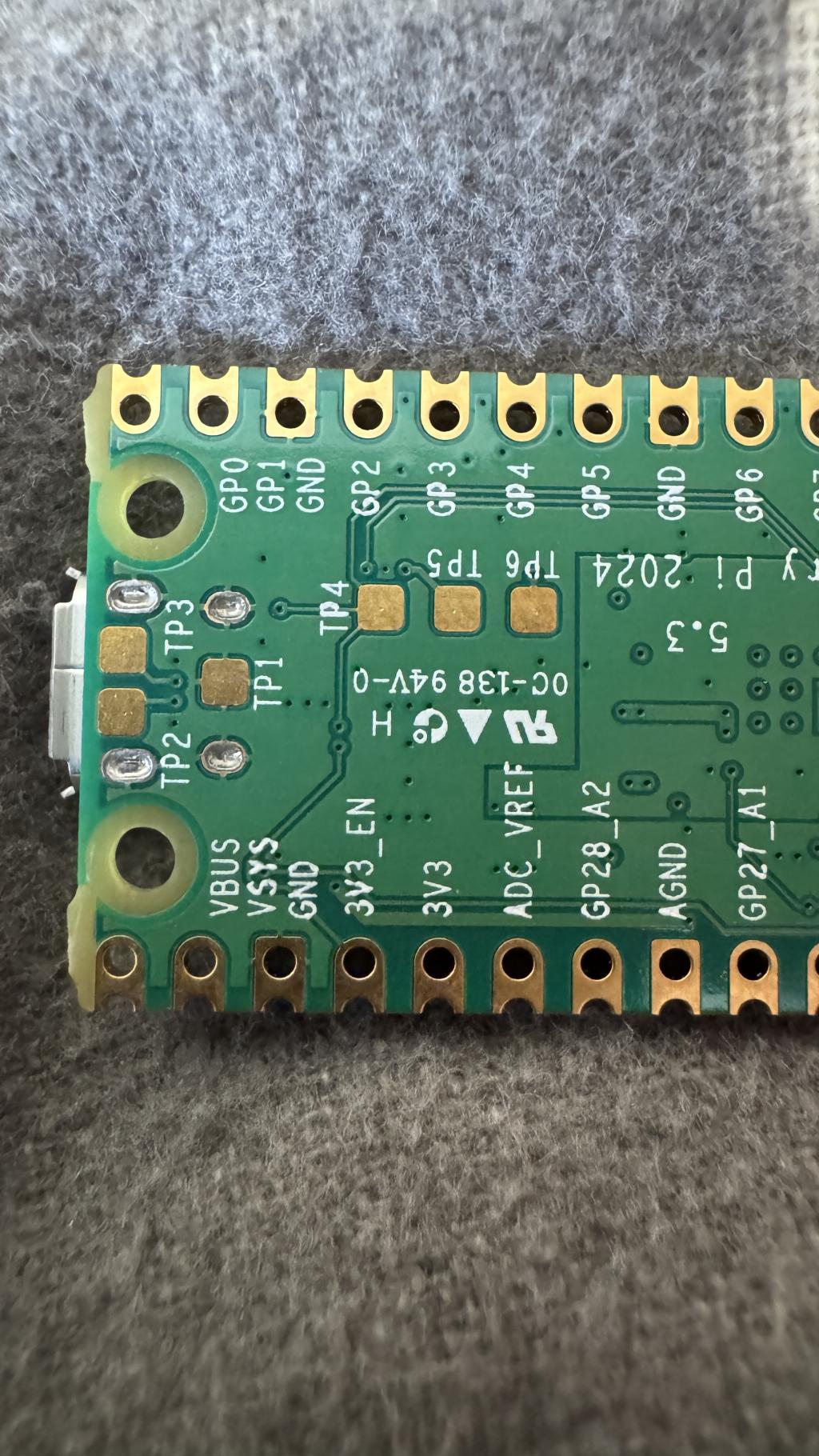

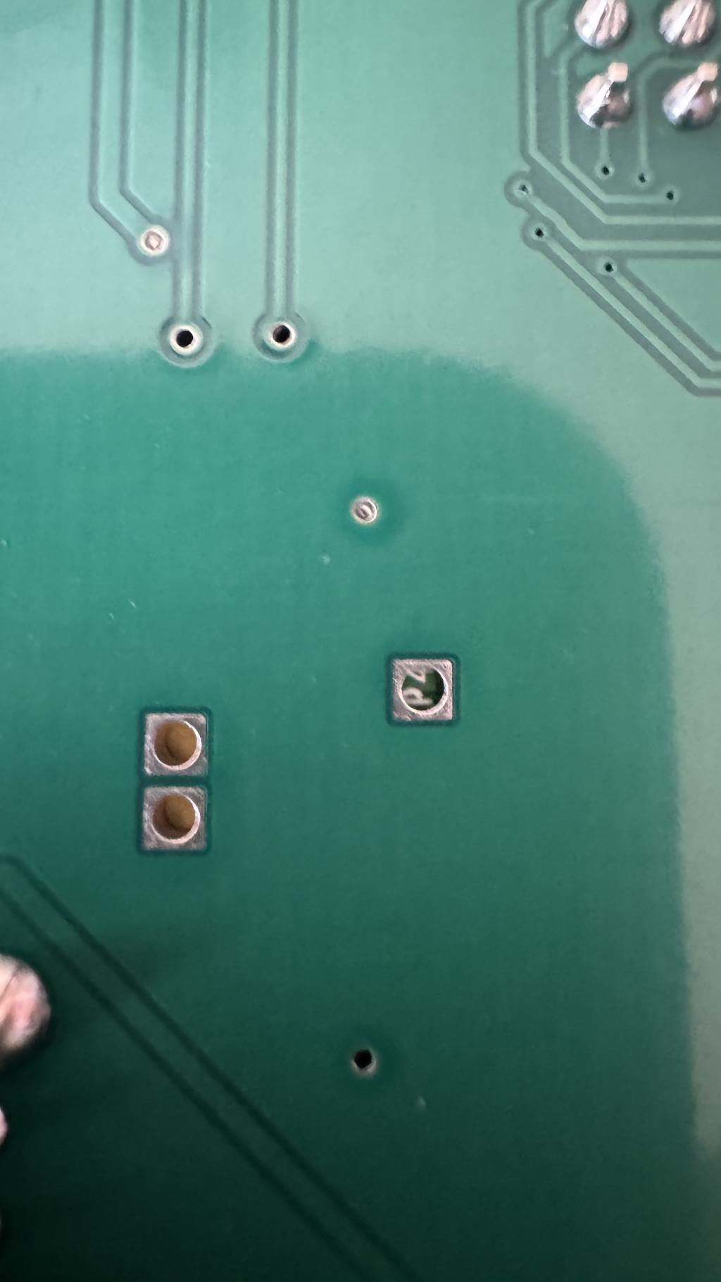

Hello!
I ordered HDMI/USB reference design assembled from JCLPCB.
Arrived, seems good quality.
One question I have:
There are 3 small hole from the backside I have to solder.
Two of them for programming connector and one of them for GP23 it seems.
But if I place the Pico2W right on the PCB I can only solder the two holes gor programming.
The third hole is not located in the right place seems.
Is it necessary to solder it also?
Is it a PCB problem? Design problem?
Thanks!
G@bor

The board is designed for the Pico2 not the Pico2W

But if I miss GP23 will it work with 2W?
G@bor
Posts: 12055
Posted: 08:58am 19 Apr 2026
You won't have access to GP23 on the edge connector, otherwise it should be OK
