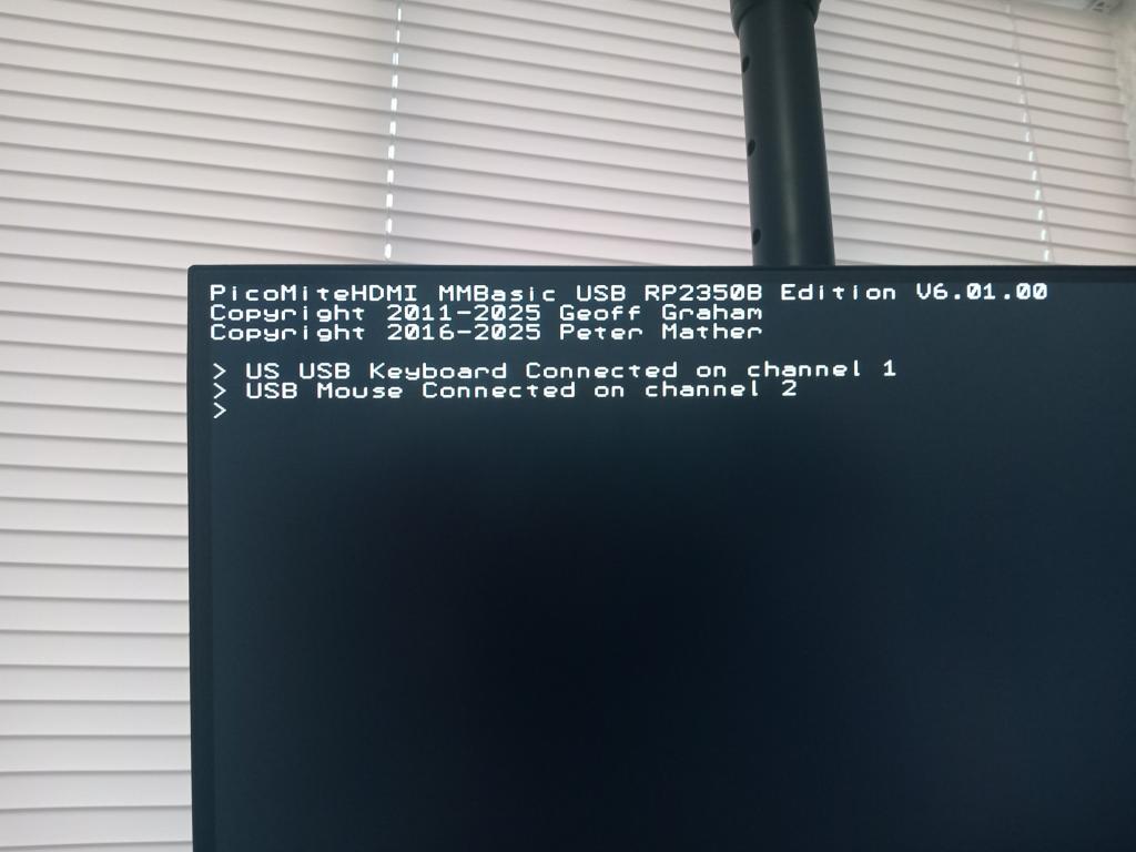

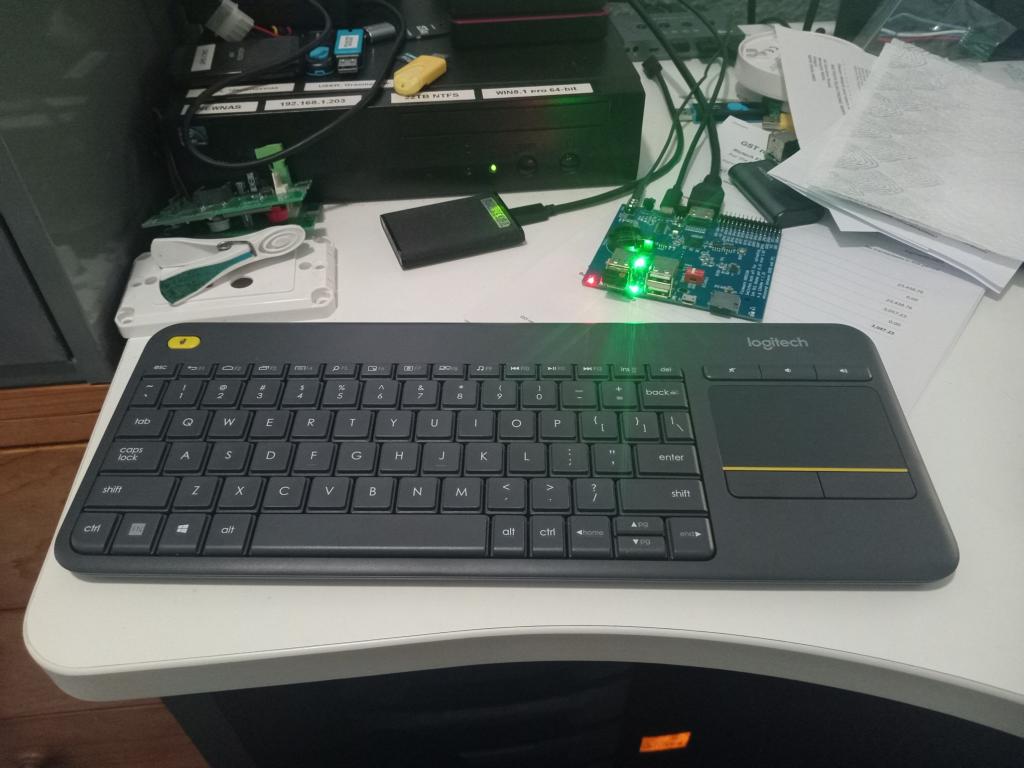

Logitech Y-R0055(K400 Plus) laptop style keyboard and touch-pad works fine.
Both the KB and the mouse, are detected fine by the hub chip and by extension, MMBASIC itself.  Entering the editor, I can move the cursor around with the touch-pad.

The fact that this works AT ALL, makes me wonder.....
Is the HUB chip reporting TWO separate devices to MMBASIC, which is why it works fine, or is MMBASIC actually working out this is a combo device?
I'm inclined to go for the former, as it has been stated that MMBASIC's USB stack simply does not have the ability to work that out for itself - but if the HUB chip was reporting two separate USB devices to MMBASIC.....
Perhaps we have more compatibility here then we realize via the HUB chip.

Posts: 11636
Posted: 07:22am 05 May 2026
  Quote  as it has been stated that MMBASIC's USB stack simply does not have the ability to work that out for itself
Who by? Not me.
  Quote  Perhaps we have more compatibility here then we realize via the HUB chip
The hub chip is just a hub
TinyUSB for the RPs is far ahead of the STM32 USB stack used in the CMM2. I have configured it to support two hubs to allow things like a RaspBerry Pi keyboard which has an inbuilt hub to be used. So you can connect a mouse to the keyboard and the keyboard to the Pico.
In addition TinyUSB supports composite devices which present themselves to MMBasic as two separate, independent devices even though they share a single physical USB cable.
